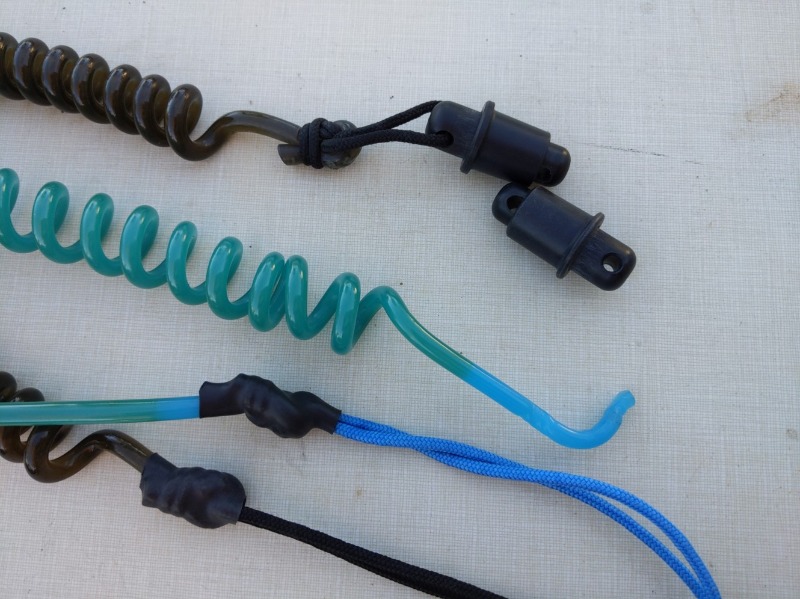

My leash-break adventure happened yesterday ("have you had yours yet?"). Got caught by a breaking wave going around a point. Had decided not to unclip (don't ask) and miscalculated. Nothing big and not a whole lot of power. Of course the boat went sideways and as I braced for getting pulled the leash just went pop. Fortunately the boat washed up on a sandy beach and I could swim in (took a while 'cause it was further out).
I'm not sure whether to be happy or upset about the leash failure. Given the outcome it may have spared me injury or an unpleasant dragging through the water. But if this had happened out in the open ocean due to a wave breaking on me it would have been not a good thing at all.
After pondering this for a bit I decided that I shouldn't focus on the leash but rather on the attachment point. It doesn't seem realistic to expect having a leash that always holds right up to the point where serious injury would occur and then releases. So I'm digging out threads about rear attachment schemes...
Pics of broken leash and intact one where I removed the shrink tube to see how the two pieces are knotted together.

Just a heads up that another friend had an epic leash fail the other day on a downwind. She had a paddle-to-boat leash as well as the leg leash so did not lose the boat but it was stressful to say the least. Same failure point as usual - plastic coil disintegrates where it is knotted to the nylon cord under the shrink wrap. See the pics in the first post on this thread for an example. I still have and use some epic leashes but i cut the shrink wrap off the knots so I can see if they are degrading. So far my remaining ones are good. Be careful out there!
