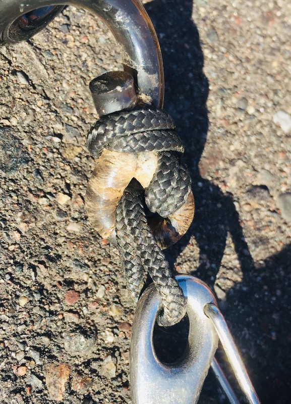

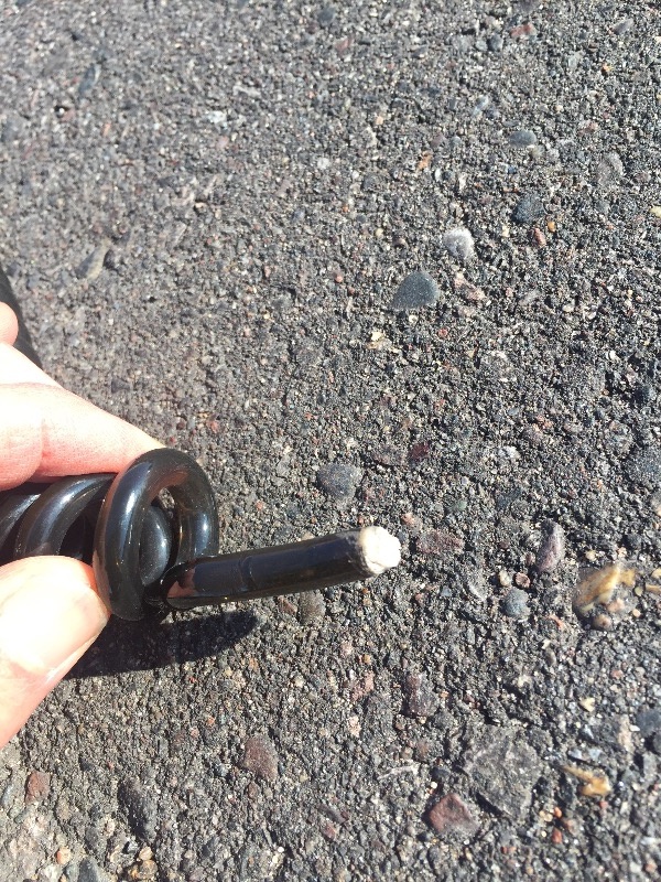

Yesterday I was on a trip in which there were 2 leash failures. The first was with an epic coiled leash. Just as we were getting on the water my friend pulled very gently on his leash as he was getting situated in the cockpit and the leash snapped. Pics are attached. The failure was where the plastic coil is tied to the nylon cord, all of which is encased in shrink wrap. I cut off the shrink wrap at the other side of the leash to examine it. While the portions of the plastic coil that are visible are strong and intact, the portion inside the shrink wrap has degraded almost to dust. Again, this decay is completely invisible under the shrink wrap and would not be noted with visual inspection. I don’t know if the decay is a reaction to the shrink wrap or do to the fact that that part probably never dries out fully. Regardless this is not a safe construction. We were at shore at the time and I had an extra leash in the car so we were able to carry on. But had my friend not tugged the leash apart at shore this could be a fatality report. He took a number of swims that day, but the first was not until we were miles off shore.
The second failure was with my other paddling partner. As we were beach landing at the end of the trip he hopped out of the boat into the surf and the quick release shackle connecting coiled leash to calf wrap had self released. This has happened to me on multiple occasions with quick release leashes and has been discussed on this forum. I believe his leash was stellar branded but all the brands have put out leashes with the same basic flaws.
This is very sobering. Yesterday’s paddle was 8 years to the day since I lost a friend on the same lake to a leash failure. That time the mechanism of failure was the velcro leg wrap.  He spent the night bobbing in 15C water while planes searched overhead and his 3mm farmer john was not enough to keep him alive.
These leg leashes cannot be trusted.  I am sure the manufactures do some testing, but lets face it you and I are effectively beta testers. Throw out any leash that has a quick release. Throw out any leash that has plastic coil mated to cord under shrink wrap. Replacing old leashes before they seem worn is probably smart .  I use a paddle leash as an additional precaution.

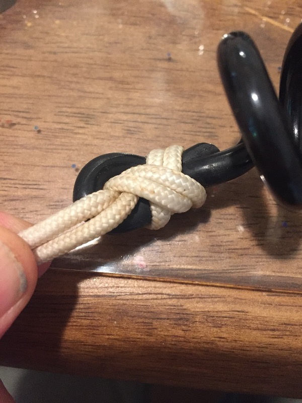

I cut the shrink wrap off a different epic leash of mine that is probably 5 years old. This one had no decay. This one has a smaller diamete plastic coil that is opaque, not translucent like the one that failed.
Last edit: 6 years 9 months ago by zachhandler.

Your´e absolutely right Zach. I had the same problem with an epic leash last year. The connection from the plastic cord to the Nylon cord looked dubious after a few years of usage so I gave it quick pull and it came apart very easily.
The plastic gets brittle with the years and I was surprised to discover that there is no inner nylon cord.
Since then I replaced the plastic cord with a rubber cord.

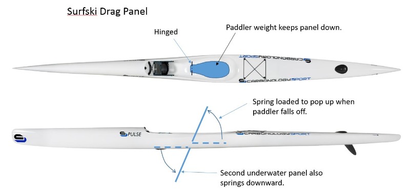

So leash cannot be too weak, but at the same time must release when needed. That is a hard requirement to meet.
Maybe manufacture can incorporate something like this in the boat. It keeps the boat from going too fast down the wind.
6 years 8 months ago #35256 by tve
Replied by tve on topic More leash failures
Hmmmm, I think you're onto something! An alternative could be some form of parachute drag anchor. I wonder what is the most effective brake in big, high-wind conditions where the entire surfski gets picked up by the wind and rolled/blown down the waves. There may be none...
6 years 8 months ago #35257 by Henning DK
Replied by Henning DK on topic More leash failures
Two problems with "braking" systems:
1) More components that may fail - will probably fail more often than leg-leashes, may even make the boat unusable.
2) Boat construction becomes more complex, less suitable for paddling, and reentry much harder with this stuff getting in the way.
So safety as well as usability will suffer, not be improved - go for simplicity, I think.

6 years 8 months ago #35259 by SpaceSputnik
Replied by SpaceSputnik on topic More leash failures
Wombat661 wrote: So leash cannot be too weak, but at the same time must release when needed. That is a hard requirement to meet.
This looks difficult to remount and hazardous when you flip the boat up just before remountung.
The first thing a surfski does in wind, is that it goes broadside to wind and waves and starts rolling.  The configuration of the drag board in this illustration would have no effect on this.
Just by the way, I lost a ski in 30kt of wind that had a paddle leashed to it - the paddle had very little to no drag effect at all and I was unable to swim fast enough to catch the boat.  Fortunately I wasn't far from shore.  ( www.surfski.info/latest-news/story/1007/...sabotage-a-sale.html )
To get around the rolling effect, any kind of drag mechanism would have to be attached to one end of the boat, not to the middle.  I think it's worthwhile to think about this issue, but in the spirit of keeping it simple, stupid, I suspect that improved leashes are the way to go.
