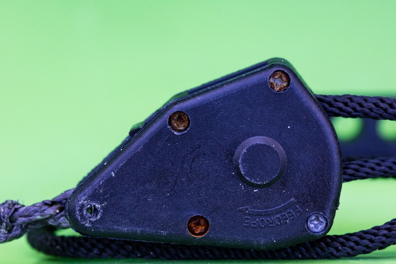

BTW, the screws in the foot pedal adjuster blocks on my 510 are all rusting out (all 8), despite regular rinsing after paddling. Is that a know nelo issue? Does nelo offer a stainless screw upgrade :-) ?

"the screws in the foot pedal adjuster blocks on my 510 are all rusting out"
Yes, that's right - I have removed those, and I am doing my own system now, to be working like on Epic surfskis. I didn't like those adjusters in the first place.

The screws will rust!
My fix to this ongoing problem is Silicon Grease (it's $3 from a scuba diving shop) and works wonders - just take care in not putting too much.

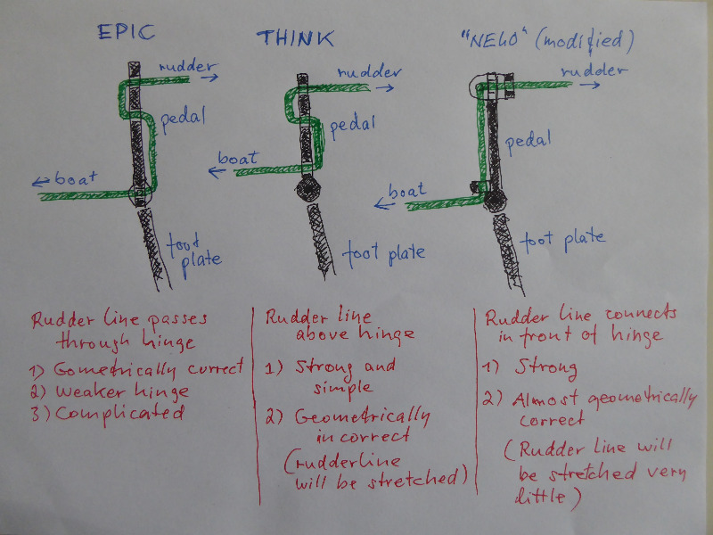

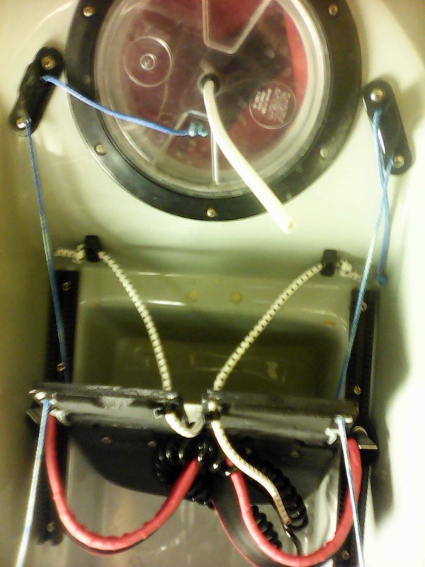

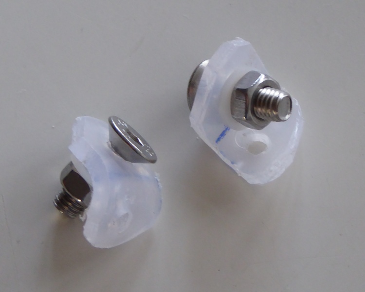

Following up on rudder line adjusters getting rusty, I have now finished my replacement, so I can move the footplate without need for adjusting either rudder lines or footpedal angle, same functionality as e.g. Epic.
I had to create a set of adapters to make the rudder lines pass through close to the hinge axle. You could probably use the ones that are originally used for the short pieces of deck line, that keep the pedals in place (I had to skip those), but they may be a little sharp on the edges, and you would anyhow need to move them so they are attached to the pedal. And yes, you have to drill some holes in the pedal, close to the axle. It's very important that the rudder lines are directed exactly towards the axle so they are not sliding through the holes when the pedals move.
I attach some pictures, hope they explain the idea ;-)

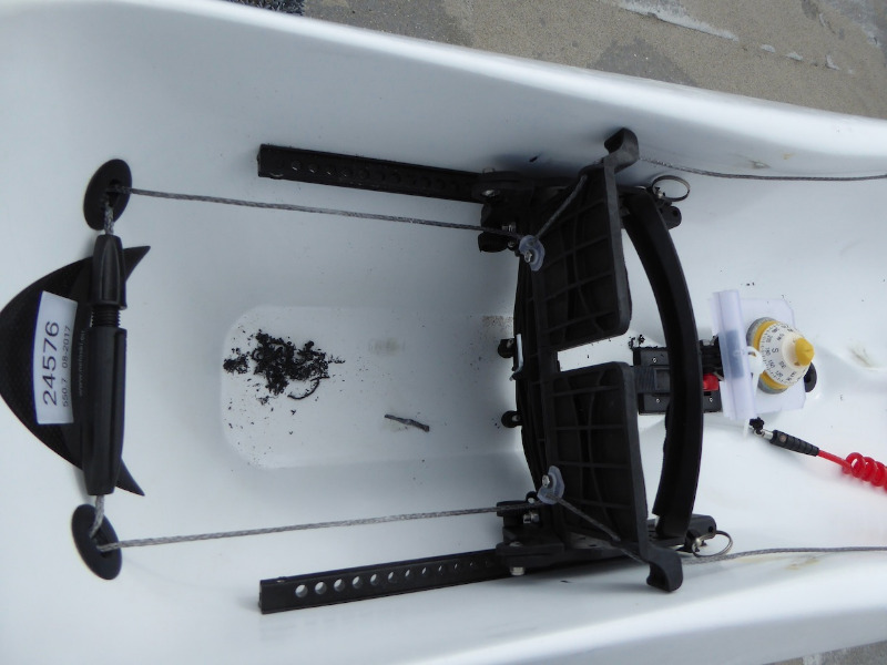

8 years 1 month ago #31439 by Hacker Mike
I also have the rusting problem, which I see as a major flaw as if these tiny screws fail, it could lead to complete steering failure. I did report the problem top the local agent and to Nelo, but the response was totally unsatisfactory.

Hey, one out of four screws isn't rusted, you have nothing to worry about! Stop whining!
Q: is there a purpose in taking the screws out, e.g. to feed a new cord through? If not, could put them in permanently...

That's a pretty sad looking bit of hardware that is clearly doomed to fail, and therefore, not serve it's intended purpose. What a shame! Reminds me a bit of Rube Goldberg.
Why is that, what appears to be a pulley, even necessary? The Think/Epic approach works just fine.

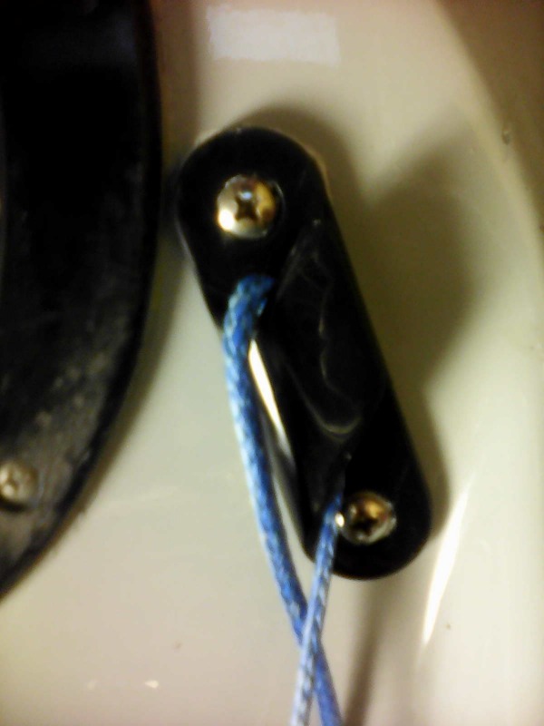

My screws are rusting too. Coming from a sailing background I've been thinking of using some floating clamcleats. You'd have to be a little more accurate setting your lengths as you'd lose the ratchet click, but I don't think it would be too awkward. Anyone see a reason why these would not work. www.clamcleat.com/products/aero-cleat-range.html

No not at all! Been using them for years on all three of my skis. Works just great. I like this style better though. (Sorry for the crappy pics proudly sent from my flip phone :laugh: )
