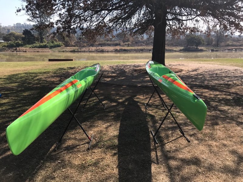

8 years 9 months ago - 8 years 9 months ago #29384 by Hacker Mike
These babies have arrived in SA. Hoping to have them next week to test

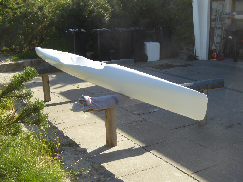

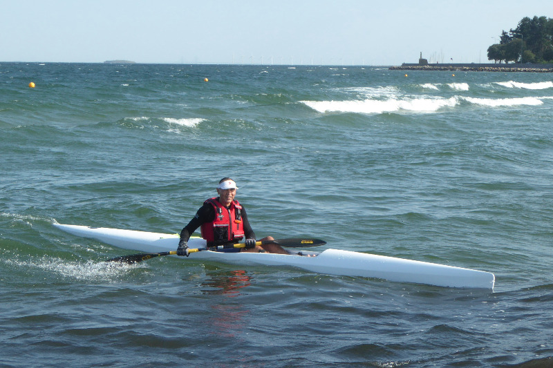

8 years 9 months ago - 8 years 9 months ago #29591 by Henning DK
Comments on Nelo 550 ML, compared to Epic.
I am now enjoying my new Nelo 550 ML SCS, and I can share my views on this.
I am used to paddling a range of Epic surfskis, and I have owned an Epic V10 GT in which I have paddled about 2000 km during the last year. I never felt completely confident in ocean waves in the V10, and I hope to get more satisfaction with a Nelo 550 and improve my paddling in big conditions without loosing to much speed in smaller waves and flatwater, which is what we have most of the time.
I am 190 cm / 80 kg and the Nelo ML fits me perfectly, with just anough extra room for both hips and even longer legs. I don't think the bucket is any shorter than in the L version, just a little narrower and moved about 5 cm forward, which is probably good for smaller paddlers in particular. I always felt comfortable sitting in any Epic ski, from V7 to V14, and the Nelo doesn't feel much diffferent to me. The final test of this will be the 73 km Tour de Gudenå flatwater race in four weeks!
First impression is stability. It is exactly as I expected and what I had hoped for, just right between the V10 and the V10 Sport. I think the seat in the ML may be a little higher than in the L model, which I have not tried, but it satisfies my need for more stability than the V10, especially in waves. I noticed that second stability is still good even when the the bucket is filled with water, which is probably because it is so low anddoes not contain that much water anyway, very nice.
Maneuverability and how it feels in the water - this is where the Nelo is different. The Nelo 550 turns very fast like the short Epic V7 or V8 Pro, but compared to even these shorter models, the Nelo is much more lively in the water, and the difficult part is not turning but rather going straight without too many unwanted deviations from the course. I think this is why some people feels the rudder is not good, but it's probably not about the rudder, but a result of the flat shape of the hull behind the seat. In my V10, I felt I was traveling on rails and it took a long curve to change direction, but the Nelo feels much more like the Elio Cobra K1 touring boat I loved to paddle before switching to surfski some years ago. It moves a lot, but once you get used to it and use your body to control it, it's not a big problem. Just feels more like a K1 than a ski, I think.
Speed… I don't know, I don't use GPS and have not raced in it yet. But acceleration is good, and it catches waves very easily.
All in all, I am very pleased with my new 550. I choose to have it completely in white, and I think the Nelo 550 is a good looking surfski, beautifully shaped. That means something, too!
Last edit: 8 years 9 months ago by [email protected]. Reason: Removed duplicate photos in text.

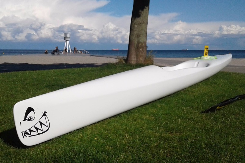

8 years 8 months ago #29863 by SurfskiEstonia
HenningDK, I feel that someone needs to congratulate You on the super clean design of your ski. Might as well be me.
Completely white and no logos or anything else. Really super B) B) B)

8 years 8 months ago #29873 by Henning DK
Must confess.. after admiring the clean organic shape of the 550, I could not resist ;-)

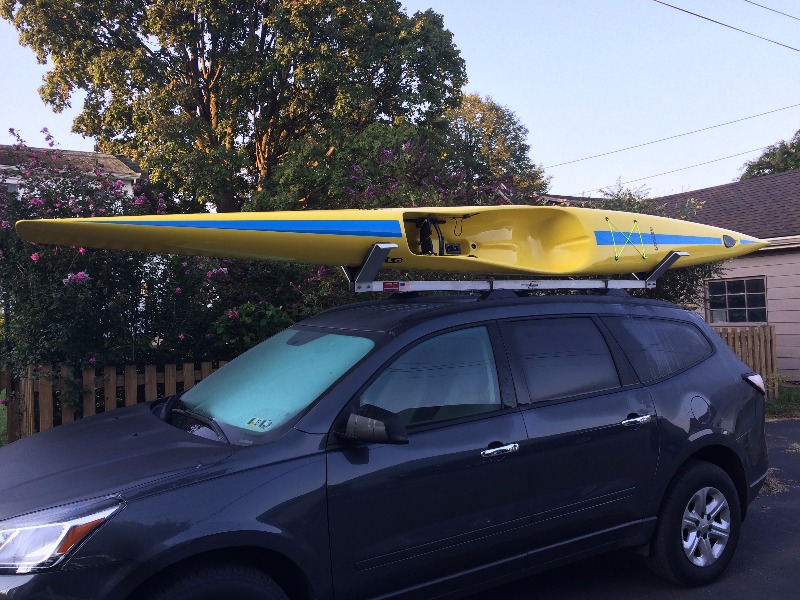

Add me to the pack of 550 owners. I'll give some more feedback after I get a couple of outings in it. My experience will be from a flatwater standpoint as I don't live near the ocean.
I don't drive with it like this. Only turned it to show off the racing stripe!:woohoo:
