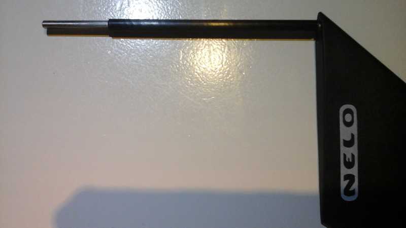

8 years 7 months ago #30127 by 100000256354325@facebook
Replied by 100000256354325@facebook on topic Nelo 550 - very brief and non-conclusive impressions
Hi,
Modification weedless rudder.
I removed the copper things and put a carbon tube over it, so it fits much better and has less play.
Wim
  • 100000256354325@facebook
8 years 7 months ago #30133 by 100000256354325@facebook
Hello,
Modification of de weedless rudder.
I removed de copper tubes and placed a carbon tube over the shaft. So the rudder has less play.
