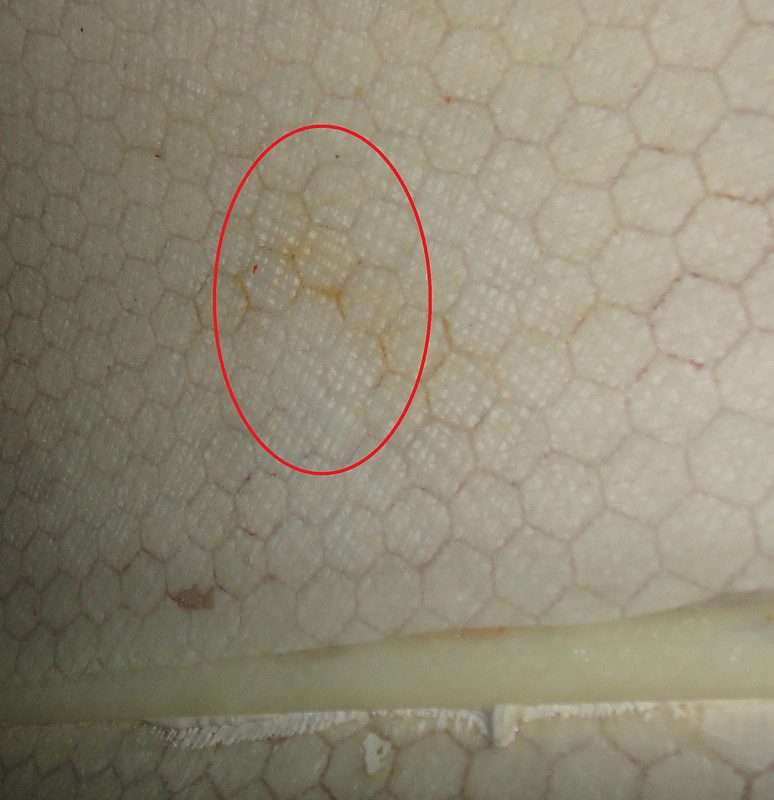

I found where it is leaking from - easy to fix. Yesterday I had decided to just fix it and keep it since I quite like the ski otherwise. I don't mind the slightly imperfect finish and the price was already adjusted enough by the dealer for the cosmetics.
However, while drying the water from the inside through the front hatch, I found two areas where the fiberglass fabric layer on the inside has delaminated from the core mat. About 2-3 inches by an inch long each. The fabric is just lifted off the mat and sticks-up in a bubble. I can press it down in with my finger and it pops right-up... It's covered with epoxy, just for some reason it has delaminated... The weight of the ski is about 37-38lb on my scale. A bit over the advertised 34lb.
Who knows what else is not glued together on this ski. This should have never left the factory and if it did, it should be so deeply discounted that one can paddle it till it falls apart and not worry about resale value...

You should get rid of the ski, interior delamination is going to be very hard if not impossible to fix properly - it would be cheaper to replace the boat.
Regarding the weight issue I wonder if the fiberglass or other composites have not absorbed water over time from the leaks - I had that happen in my carbon/kevlar sea kayak just from damage to the gelcoat and I was amazed at (1) how much water soaked in and (2) how long it took to dry out. I've been fastidious ever since in touching up my gelcoats but a boat with a serious leak like yours would be another matter.

The delaminations probably no one noticed since you have to look quite carefully to see them due to the location and patterns of the fabric. They are not at all obvious from the outside nor does shining a light through the hull show them as shadows. One has to look at them from just the proper angle to observe that the fabric there is slightly raised, and if you have long hands can actually feel it give-in from the inside of the hull only. That's something I missed the first time I looked at it despite the fact that I was looking for issues given how sloppy and obviously touched-up and sanded-down the outside paint/gell coat was. So I imagine whoever did the QC of this boat probably missed them as well.
Just something to look for if one buys a ski (any ski, I'd guess, not just a Think). But with most skis that do not have hatches one can't really see such delaminations at all...

13 years 6 months ago - 13 years 6 months ago #6916 by Kocho
May be time to split the thread since the original was about the overstern rudder...
Anyway, here is a photo of the couple of delaminations I can see. Sorry, hard to get a camera there but I think it is visible enough. You can see that there is also beginning to have some discoloration there due to the water that was leaking inside through the scupper area (now I had fixed that, it appears, so no more leaks).
Much easier to feel than to see - just push the fabric in with a finger and it gives-in then pops back-up when you let go...
