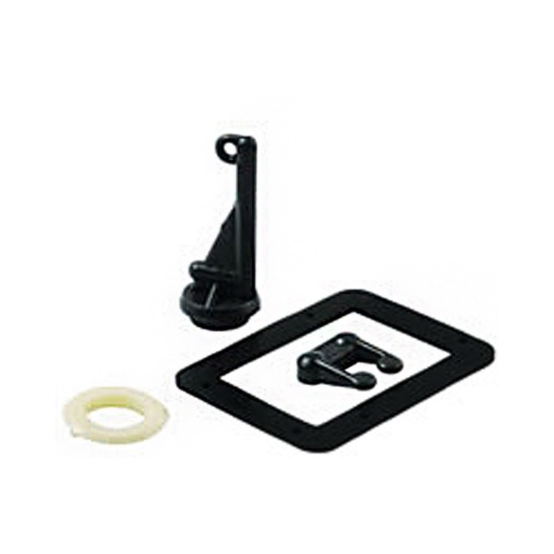

Fath2o, not a DiBrito or Anderson, this was a Hoyt Allen on my old Cobra Eliminator. It was very easy to change all the sealing parts with this rebuild kit. I sourced it through Annapolis Sailing (APS). They have rebuild kits for Anderson. The bailer leaked when I bought it but worked pretty good after the changeout. It's almost impossible to keep water out of the ski anyways. I can't see a DiBrito to be a difficult task either.

I just stumbled upon this thread because, well, I need to replace the gasket on my deBrito drain.  I just cut one from a sheet of neoprene I picked up on Amazon for ~$10.  I'll let you know how it turns out, but I want to pass along a template deBrito has for cutting out that gasket at:  debrito.se/drawing.html

Thanks, I bought a $15 sheet of neoprene and replaced the gasket using this template and it worked fine on its maiden voyage, only a few drops of water in.  I'm leaving the bailer closed to see how long it lasts.  The old gasket was compressed and torn so leaked a few pints every few minutes, so had to open and close it often,
i have leftover neoprene, so I can use the rest to make people gaskets if they are interested.  I'd charge $5 including shipping for two of them  as long as shipping isn't more than 2 first class US stamps. My home from college student can make a template out of plastic for more precise cuts of the neoprene.
I used XCel 3mm neoprene which got good reviews on Amazon.
