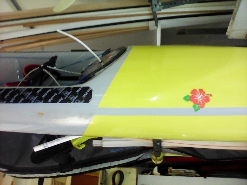

I'm still a PVC tape fan. It is cheap. Readily available at home stores etc. Very easy to apply and remove. Leaves little to no residue when removed. 100' roll will do 25 surfskis. Did I already say it is cheap.
www.walmart.com/ip/JVCC-PWT-20C-Heavy-Du...0-ft-Black/113310964

Kirk: not everyone likes putting black tape onto a white ski ;-). Otherwise you're correct that it's the simplest and cheapest option.

Thorsten, are you suggesting that my pvc tape clashes with my hibiscus?
