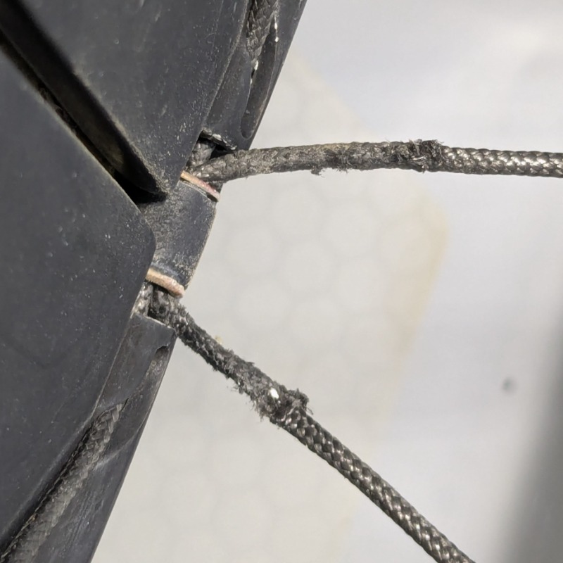

11 months 2 weeks ago #41324 by LaPerouseBay
Replied by LaPerouseBay on topic Kai Waa Vega Arc
Thanks for the heads up Paul and Ranga.
My lines were chafing, so I replaced them.
I asked the fishing supply store for 1.5mm.
The smallest solid braided Dyneema line they had was 1.8mm.
It fits fine. I'm guessing the Ozone line was very close, maybe 2mm.
The new stuff was very easy to run, much easier than Epic lines.
The solid braided Dyneema is like wire. I probably could have pushed it thru.
I didn't want to risk pushing and bunching, so I taped the new line to the old line with clear packing tape.
I started at the pedal and pulled thru one piece, to the opposite pedal.
That's how Kai had tied it up, so I matched it with one piece of line.

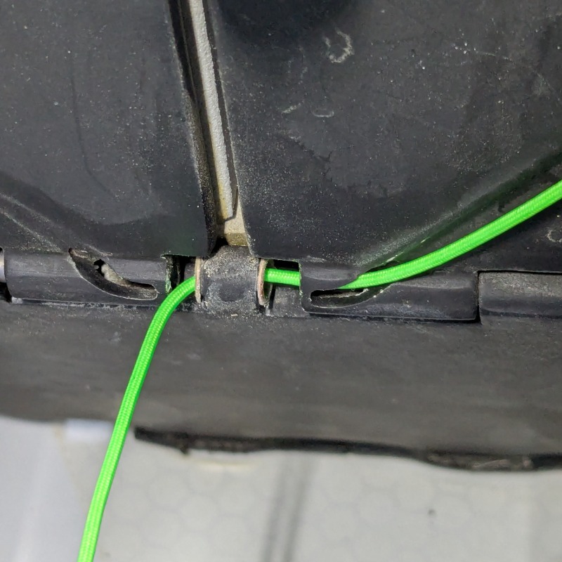

Here are some pics that show the sharp right angle that chafes the sheath.

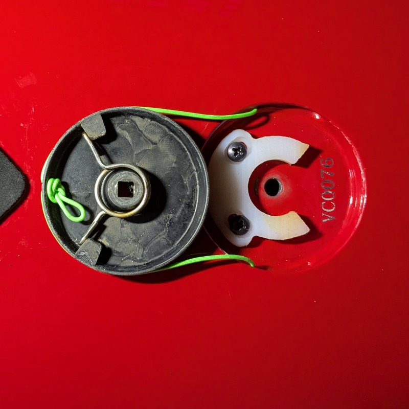

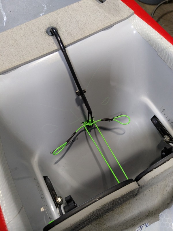

That's how the lines run, if anyone's curious.
Pedal spring cover upside down.

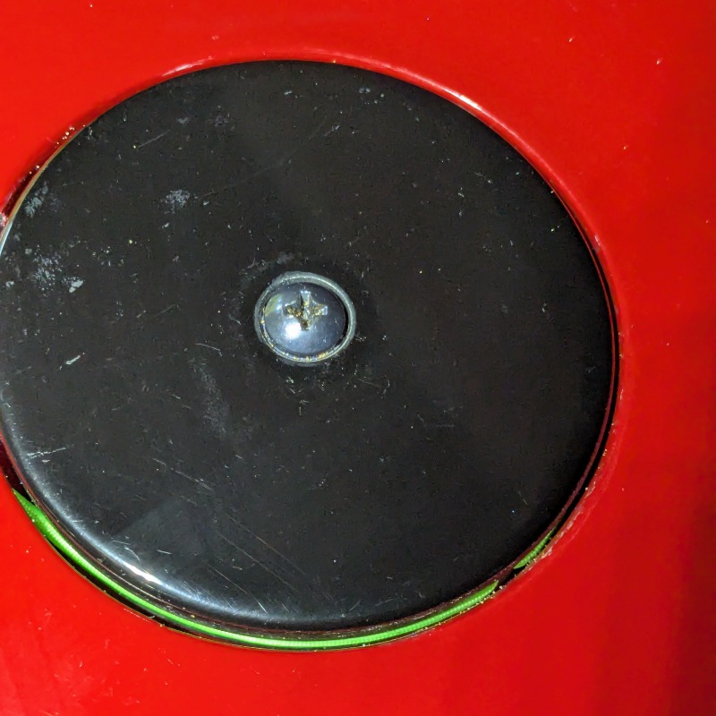

Installed, you can see how the lines run. Very simple.
Vent is working great,
