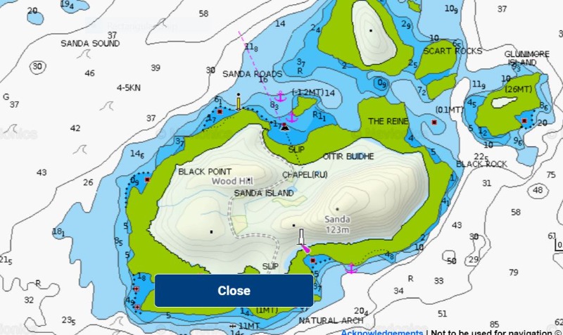

5 years 7 months ago - 5 years 7 months ago #37698 by waverider

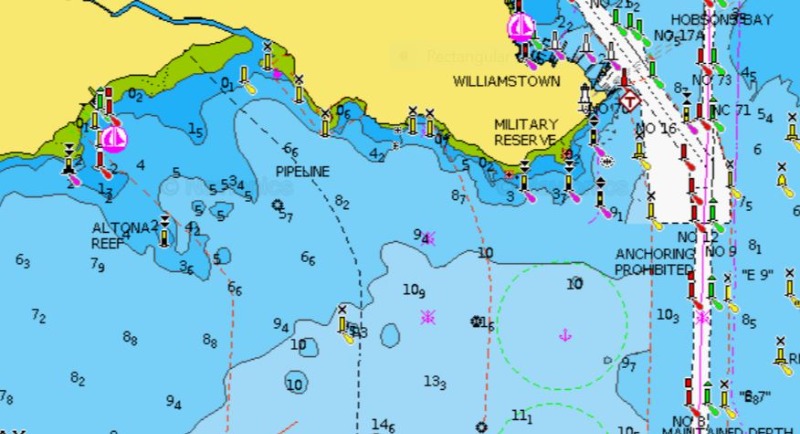

Coming from a kayak fishing background we use navionics, gps maps, obviously the integral version with sounder is a no go as it requires batteries etc, but there is also the mobile ap version. You would have to set it to sleep mode so it only fires up when you want to look at it, or the ap chews through phone battery. I would suggest using a separate phone for this reason. the phone ap has a positioning curser, and can plot path if required. Different map overlays possible, showing terrain etc.
Really wouldnt be hard to have an extended mounting bracket from either forward bulkhead of behind foot board, to mount something within reach other than using footstrap
kayak fishos regularly rely on this ap to navigate around in the dark when they cant see any landmarks at all. Definitely get you home in a fog

5 years 7 months ago - 5 years 7 months ago #37700 by LaPerouseBay

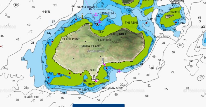

I had a look around the web when this thread started.  I agree with the Navionics suggestion.
If you add a bluetooth GPS antenna and link it to the phone, it will save your battery.
Personally, I'd never venture out in the north Atlantic without an experienced guide and every possible backup system known to man.
I may try the Navionics app.  It's only $14.99 for the U.S. maps.

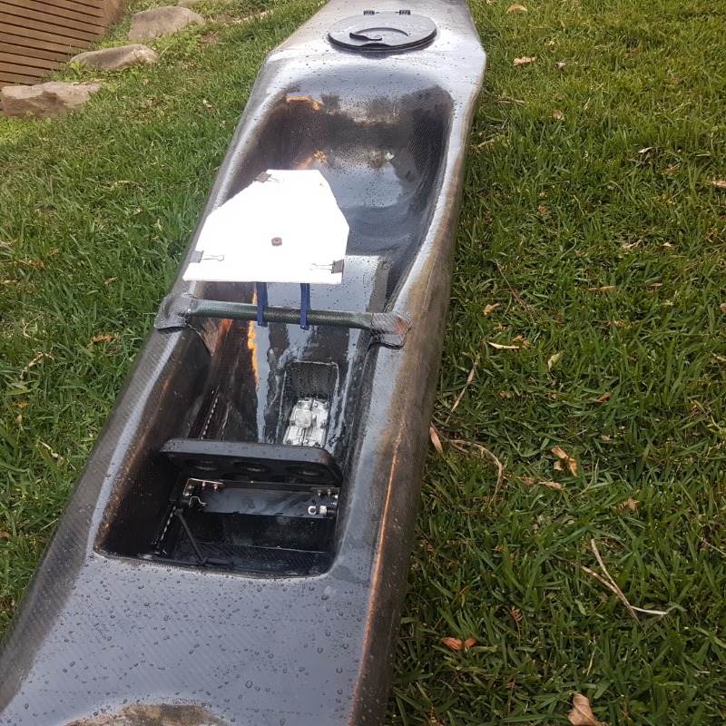

Did something similar for an adventure this year, hopefully the photo uploads, it makes more sense than my description.
Older model Miry mtb map board with a piece of coreflute cutdown to a smaller size.
Thought about using a cutdown carbon handlebar to mount it to, but ended up putting a carbon sleeve over some plastic conduit.
Step 1: Essentially you're making a carbon tube with flat ends.  .
Cut the conduit just wide enough to sit on the top of the footwell, squash the ends of the conduit flat with a heat gun + a vise, then wet out the carbon sleeve and vac or heatshrink it over the plastic conduit.
Step 2: Make some L brackets that are custom shaped to fit the footwell
Cover the sides and top of the footwell with plastic and layup up some carbon strips to make a "L bracket" that goes up the side of the footwell and over the top edge.
Step 3: Join the L brackets to the carbon tube
With the brackets still sitting in place on the boat, go crazy with some scrap bits of carbon and join the L brackets and the carbon tube.  Once it's all cured, add some decent quality velcro to the back of the brackets and the footwell to add a bit more security.

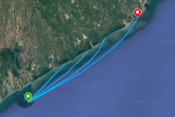

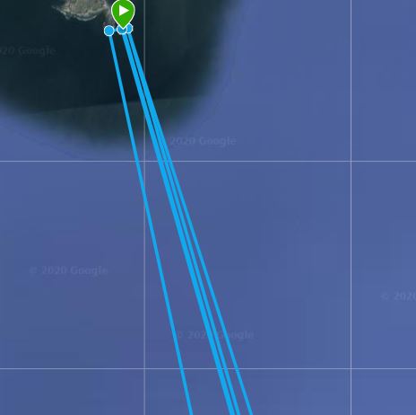

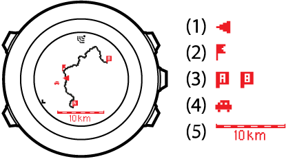

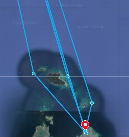

5 years 7 months ago - 5 years 7 months ago #37710 by sarzelopez
Sorry, I didn't mean GPS waypoints, but the literal route/possible routes.
Tides are regular, so I just always know where im at tide-wise.
I only do 3 routes where the wind could change my landing spot or route. 1 of which is the long off shore one where you can't see anything but water until after about 16kms.
This is how I saw routes on my suunto.
You can change the scale, I used 200m instead of 10km
If no matter what happened I was landing at point X, I just drew that route and followed the path. I can't see any way this can go wrong. The chart  would be usefull for drawing the route on the PC going around the sandbars, lighthouses etc. The way I did, I YOLO'd the route on a super low tide, so I could see everything and then drew that one.
Another scenario is where you take off from one place and depending on the conditions you might want to change your landing spot. In my case for this 20km run, I am familiar with 3 beaches in between the real destination, so I draw the route to the 4 possible landing points on the same course,I start on the real route (farthest from the shore) and if I want to fold, I just jump to another line. Again, I have it plugged as if it was one big 90km or whatever route, with the lines branching out from the starting point.
The last scenario is for the off shore, where the landing spot is the same but depending on the wind you can take about 3 different lines. Again, I put the 3 lines in the same "course" and depending on the forecast 15 minutes before the start, I know which one to follow. If I'm taking the one in the center but the waves/wind sart coming in strong form my left, I can either adjust or completely jump to another line.
PD. This are training/race route planning, I guess some similar planning can be done for expeditions, sightseeing, touring.
Quick Edit: the best scale is 200m

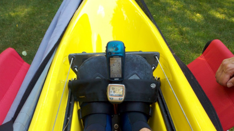

5 years 7 months ago #37740 by ccchappell
Like Zach says, a GPS in Navigation mode with arrow and waypoints works great.   Here's a picture of a set up I used years ago for a foggy Blackburn Challenge (20 miles around Cape Ann).  I made a simple bracket from a piece of aluminum, bolted to footplate then mounted a small held Garmin.  Then had my Garmin 310 on the foot strap for typical metrics.   Downloaded the route to the hand held, put in navigation mode and watched the arrow point to the next waypoint.  Really like having the two separate functions.  Once I started them didn't have to touch.  I know this doesn't give a map or chart, but agree the Nav function is great.
