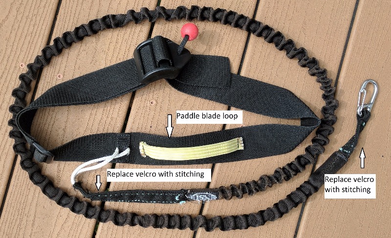

This one is quiet on the back of the ski and gets me to to and from the water without clipping out. Calf leashes were a hassle to unclip in rough conditions when I was a beginner and downright dangerous if caught out with whitewater bearing down on me.
I think I may get a helmet too for surfing. I got beaned on behind the ear last winter and it hurt for a week. A few inches forward could have been lights out.
My vest is the Wingman. I got it for 150 as a kickstarter. They are 250 now, which is too bad. Great vest, rugged etc, but spendy. It's tiny and I can swim in it if need be. The paddle loop on my belt is just big enough to drag a blade if my leash ever breaks. I've tried several and broke them all somewhere except this one. So far.

I got that idea from the standup surf gang. Some shorts have a dedicated loop for dragging a paddle.

Thanks for all your messages they have been really helpful. I have gone for an ION - SUP Core Leash RACE 2.0 coiled hipbelt. This is following on from JML and LeParouseBay s comments.

It should be very easy to straddle entry with a belt/trailing leash. The only thing to be aware of is not allowing the leash to get around the rudder. There is enough slack, it happened to me - once. It's easy to control the leash as you get in. Just be aware of it. Reach back, or look back if you can, and make sure it's on top of the deck.
I can't imagine a straddle entry with a calf/ankle leash that has a small, tight coil. It may not have enough stretch to get the leg behind the bucket. The advantage of small tight coils is less mess in the cockpit. Big sup coils on the calf will allow a straddle entry, but that's a big mess in the cockpit. They stretch out and get nasty hence the need for small tight ones.
