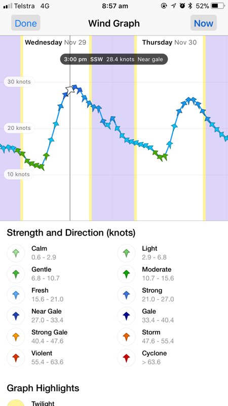

8 years 6 months ago - 8 years 6 months ago #30474 by Watto
Replied by Watto on topic Leashes with clips
Facebook post attached re the leg leash failure and subsequent rescue by submarine of Ken Dinham at yesterday's Doctor in Perth. Owenfromwales originally posted on this - see www.facebook.com/plugins/video.php?href=...10155958534949187%2F well done Brett (AR_convert).
While a strong sea breeze around 25 knots this blow and swell not uncommon in Perth during summer. Pic attached midweek blows coming up Wednesday and Thursday for example. Although Ken's leash failed out in the shipping channel maybe 10kms from shore with larger swells than those we paddle in our downwinders 500 metres out, this just highlights again what this thread about - importance of dependable safety gear. In this race you are indeed all at sea. Rottnest Island where the paddle starts is 19km directly west from the coast - The Doctor course a dog-leg Rottnest to Sorrento Beach is 27 kms.
And on Ken's circumstances, though the water temp pretty temperate here around 21-23 degrees C at this time of year, mortality risk still there with prolonged exposure, not to mention men in grey suits, plenty of which about. Despite rescue craft out there it's extremely difficult to spot someone in the water in those conditions, you'd know if you've been there. Advantage of that sub not shared by standard rescue craft is height above wave level.
Why not GPS chips on each boat/SUP in these events? Excellent way to track your paddler too. No criticism of Dean who manages this event brilliantly, however an option possibly.

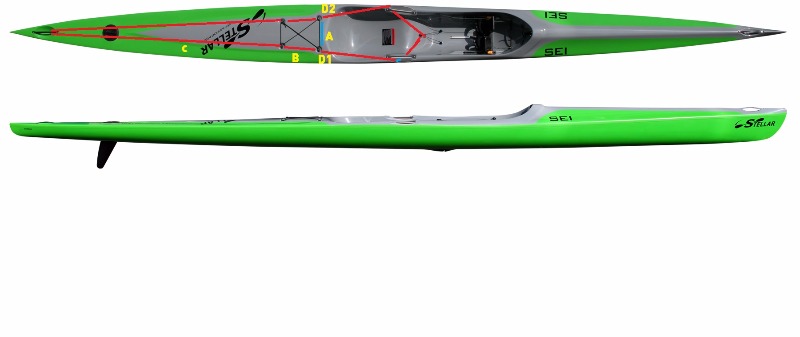

8 years 6 months ago - 8 years 6 months ago #30476 by HangTen
Replied by HangTen on topic Leashes with clips
Owen,
Not sure I completely follow what you describe in your second post in my mind and also not sure I'm fully following how you'd be using your two carabiners in the previous post. A picture's worth a thousand words or so they say so here's what I was thinking.
The blue line at A is how you currently have it. I thought you would have both carabiners clipped in at A so you only have to pad that area. If you needing to get to the rear to clear weeds or jam your rudder you would unclip the carabiner let's call it L1 from A, leaving L2 clipped in there at A and depending on how far the play in your leash was you'd clip in L1 at either B or C, and then unclip L2 from A. If L1 only reaches to B, you would now clip L2 into B, and then unclip L1 from B and clip to C, and then unclip L2. I feel like one of the benefits of this system would be that it would allow you to keep your leash as short as possible to reduce risk of tangling or wrapping around your neck or something. The carabiner could never "pass through" from A to C because it would be interrupted by each of the two consecutive deck bungee fixtures.
Now the modified extended deck line, we extend from the first rear two bungee attachments as before, but instead of passing through A, we now go through each respective handle and meet up at the footwell leash attachment point. We've just continued the system as before, if the carabiner is leashed forward of the handle, it now would not be able to "pass through" to D and would still be caught up at each deck bungee attachment attachment. Hard to see if where it crosses the cockpit would rub you or if it crosses too high at the hump, but hard to see from my end, but I'm thinking you don't need for it to be completely taut. See how much play you need for it to not get in the way; you might find that even with sufficient play the line wouldn't trail over the side at B or C into the water.
If it does, what about this: What if you thread the line through some cheap suction cups at D1 and D2(not for the purposes of providing any resistance), but simply to allow you to have the line taut between the D1-B-C-D2 line, so it doesn't trail at all, and then have slack between D1-D2 on the bow end so it doesn't interfere with your leg drive? The suction cups would come off is any serious force was applied, but you could just stick them back on.
Replace the dog clips dude! I would hate for you to perfect a sweet setup only to have a dog leash crap out on you. If you can go to a climbing store go check out the multi-action carabiners and handle the action, you might find that it's quicker than you think. I can work mine with thick neoprene paddling mittens on. Although I have the quick release on the rescue belt as a redundancy, I actually also carry a line cutter as part of my kit in case worse case scenario my carabiner won't release and belt won't release the line cutter should make short work of it under load. Especially for those of you who plan on making really long DIY leashes I think it's a useful tool to have in your kit in case that extra play should result in entanglement in a situation where you don't have enough time to untangle yourself.

8 years 6 months ago #30477 by owenfromwales
Replied by owenfromwales on topic Leashes with clips
Nice image Hangten.
What I have in mind is much simpler. I`m thinking ignore using the bungee points, go from rudder handle direct to side handle each side, then have the line go direct across the seat, between the two side handles (ignoring the leash anchorpoint).
I know this sounds crazy so far, but bear with me. My idea is when you sit in the boat, the line across the seat will be pushed below the paddler`s thighs. This in turn would tighten the deck lines to bring them out of the water. (they are slack when nobody is in the boat). If I fall in on a wave and the boat keeps going, then two clips will slide to the back handle with out me needing to unclip/reclip anything. Likewise if I need to jump off for some rudder surgery. I`m not worried about scratching the deck and like you say, hopefully the clips won`t actually be travelling the length of the boat that often. One drawback is that I could no longer reach the front end should I have to inspect it mid-ocean, without unleashing.
Hopefully, when I fall in, the renewed slackness in the line will allow the clips to travel slightly passed the rear handle, thereby sharing some of the load between it and the two side-handles.
The join in the line would be between on of the side-handles and where the clips are nearest to me.
