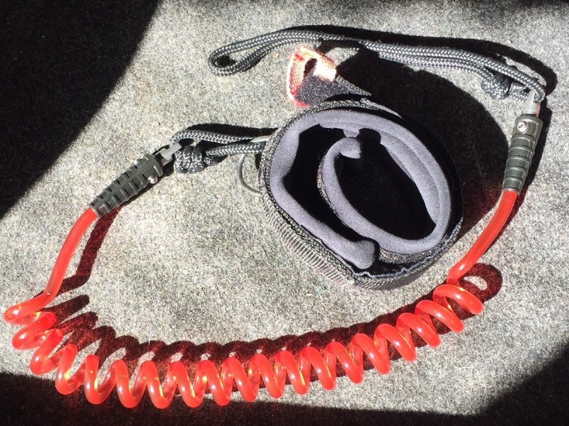

It's an interesting point; I use a Mocke leash that has a clip like the one in the video. But... I have modified it by putting a kite boarding quick release clip onto it... That release has a swivel which makes it less likely that the sideways force required to undo the Mocke buckle will ever occur.
So I'll be continuing to use my solution - which I use with a belt rather than an ankle strap. The reason I use a belt is that I injured my knee using an ankle strap, while standing in thigh-deep water. A wave came in, pulled the ski from me and the leash gave my knee a nasty twist.

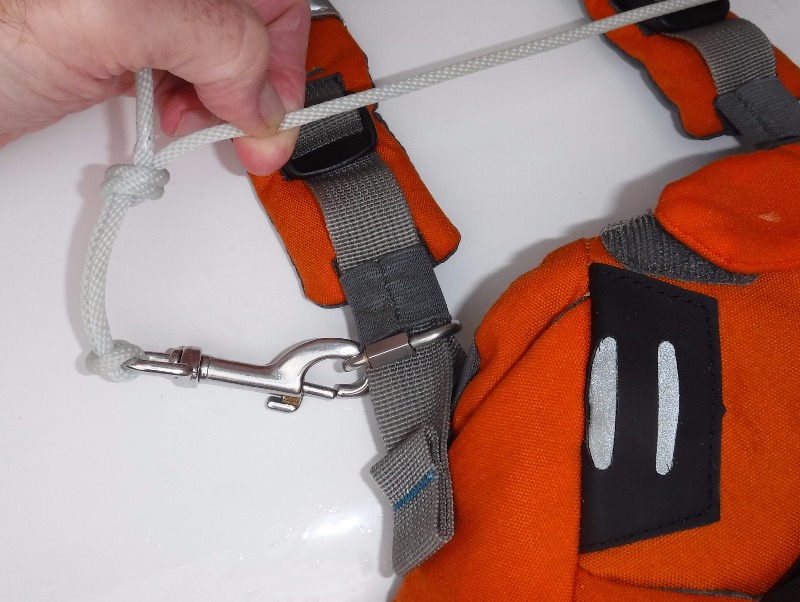

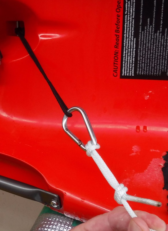

This is one of the reasons why I make my own leashes. I put a carabiner at each end. One end clips onto the leash-plug via a short surf leash style loop, the other clips directly onto my pfd. Whilst practicing remounts I found that a velcro strap above the knee came off way too often. Now it`s secure, but easily detachable when needed.

The boat end of my leash has a carabiner which clips onto the small rope to the leach anchor. At the other end I use a stainless dog-clip. This clips onto a stainless loop on the webbing of my PFD. In case of emergency I can unclip the dog-clip in a second. It`s easy to find and open with one hand without worrying about it opening accidentally.

I've been using a Mocke leash for years and have come off a couple of times this year, once in the surf.
I've never had problems with it: never broke, never detached, never tangled badly with my paddle leash.
I use it with a belt rather than a velcro ankle strap; I prefer the belt because I had a nasty knee sprain years ago while wearing an ankle strap (wave hit while I was standing on a reef holding the boat).
One of the things I like about the coiled part is that it's short and doesn't get in the way - how do you manage a long rope in the cockpit? How do you prevent it from being sloshed under and around the foot plate, for example?
I don't have an answer for the concern about unclipping to go to the back of the boat. :-(
A leash is never going to be a silver bullet - it's a component in a safety system. If it's too weak, it might break and you'll lose the boat; if it's too strong and you don't get it off in surf, it might hurt you. If it's too short, you might lose the boat if you unclip and have to go to the back of the boat offshore; if it's too long it might tangle and cause a problem... Life is never simple.

Personally I don't think the clip on the Mocke leash will ever fail as the swivel at the end of the coil prevents any rotational force from the leash from being transferred to the clip.
However, I never used the clip on my leash and found it got in the way, rattled against the ski and could potentially damage the gelcoat when getting in and out of the ski, so I decided the remove it and replace it with a permanent cord, as per the attached photo.

A couple things I would point out in your setup. If you have the appetite for it, I would recommend splicing your line rather than tying a knot. Even if a particular knot holds in water, the nature of a knot compromises the strength of the line at that point by like 40% so you don't have the full breaking strength; whereas a splice maintains almost full strength. Granted it might take a little practice learning to splice and more than 5 mins per season especially if you splice double braid line but might be worth considering.
The carabiner you're using is the kind that can self-unclip, so I personally would replace that part as well as the dog clip. I feel like the dog clip could also definitely come undone by itself and not sure what the load rating on it would be as well as making sure the spring inside is also stainless.
Also, hard to tell from the picture, but make sure the strap you attach it to is built for load. Some pfds have built in harnesses while others have straps that would tear out under load.

Hi Hangten,
No worries, all ideas/advice gratefully welcomed! Like Rob said earlier, we`re forced to compromise some way or other. The best we can do is pick the options that best suit the conditions under which we paddle.

On the Mocke leash, the first issues I see are again knotting instead of splicing the lines.
Also, I feel like velcro really shouldn't be a part of the leash, because it's a significant point of failure. Also, not sure what type of velcro they used(there are actually different types of velcro with different shear strength) or how much because there is a nominal force where the two faces will slide against each other and come undone that decreases over time.
Also, I'm not a fan of the bungee line/general design they borrowed from surfboard leashes. I feel surfboard leashes don't really have the same design considerations because you're much closer to shore if you become separated and in the breaking waves of the surf zone you'd actually want the line to snap under extreme force; on a surfski you'd never want to stay clipped in entering this zone. I've read the surfski leashes with this kind of material is designed to stretch, but had not found information on the nominal breaking load as well as the effects of repeated stretching and uv degradation.

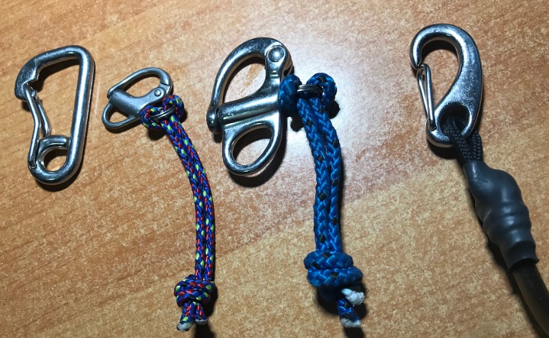

Back to Rob's point really, you can only do so much, ain't no silver bullet. Pics below a range of marine hardware, used them all. Probable easiest releases are middle two below (actual size) with a bulky catchy cornered yachting clip left and standard most common quick release right (current preferred). Disadvantage of middle two is potential for inadvertent release if cord caught anywhere will open pin and release leg leash line.

I've personally had the one on the right (in Watto's image) unclip on me and have stopped using the two leashes i had with that system. Also had a friend lose her boat on a fairly windy downwind due to the exact same clip releasing from the leg end.
