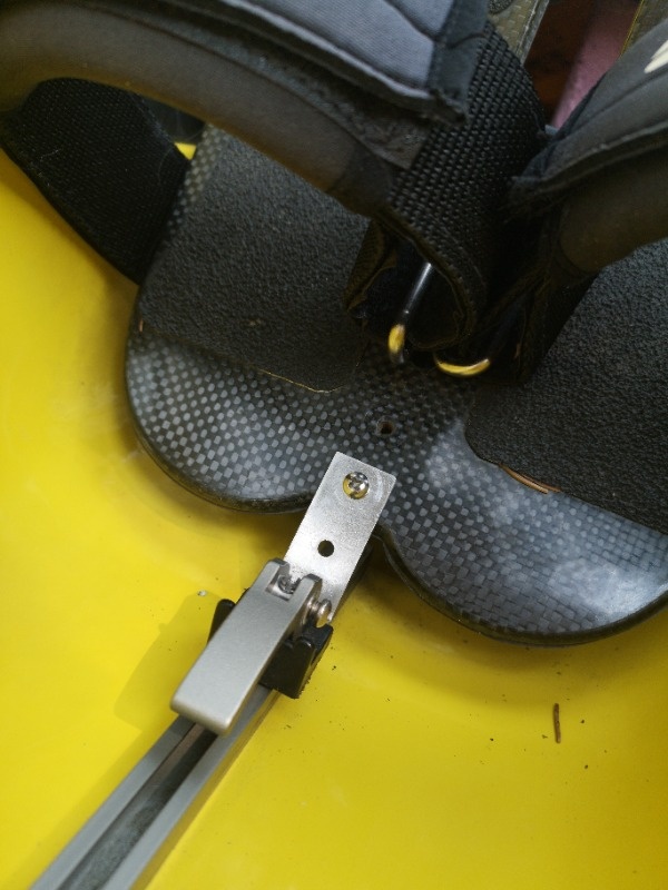

5 years 2 months ago #38502 by Jipsu
Thank you all for your tips. I must say that foam roller and fascia ball have been close friends on mine and seem to help.
Howevever, I made one fix on my ski, you can see it on the picture attached. I just simply removed another of the footplate/hull rail attachment screws and then I was able to tilt the whole thing forward. Now, as it is supported by one scew only, it may not be so durable, but that may be rather theoretical problem. And as that supporting angled stainless steel plate is so simple, I can make different versions of them easily if necessary.
I havent tried my boat on water after that modification, but on dry land I felt my posture better. Perhaps this helps...

5 years 2 months ago #38508 by waverider
A couple of notched hard rubber blocks under that lip will help keep the strain off that screw, otherwise foot pressure is likely to pull it
5 years 2 months ago #38517 by Jipsu
So... Two evenings in different conditions with this setup now... Both 10 km quickies.
I must say that it feels better. However, I might still need to tilt it 1-2 cm more.
I can say that after that little modification my rotation got "better" (read: more efficient) and I was able to maintain better speed. - Stability felt different (wobblier) in side chops, but that is just a ghost of the change, I guess.
So, some more metalwork and core training could be enough to make my day (or even summer). - If not, thats the point when I try modify so called "seat" of my vessel.
