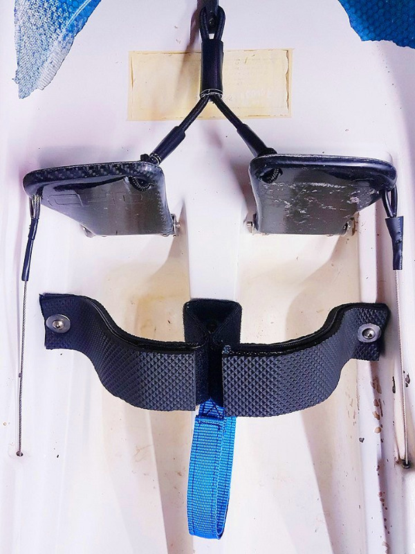

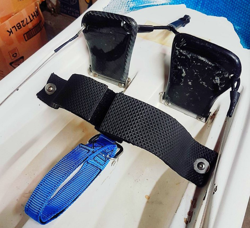

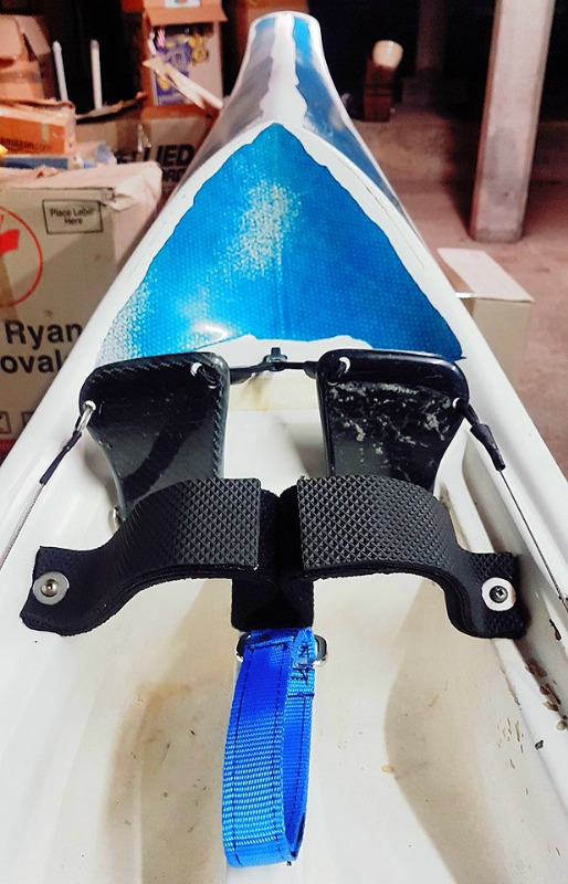

While I was busy trying to tidy up a few things on the Ski I decided to try my hand at making my own Footstraps. I thought I might share the results for the benefit of anyone else in future that may have a notion to do the same. These are heavy duty Velcro, fully adjustable, rubber cushioned top and bottom ( over arch of foot for comfort ) with a fully reinforced core made of 2200kg break resistant webbing. They are a little stiff right now but will break in immediately.
Images attached for inquiring minds ... Cheers
