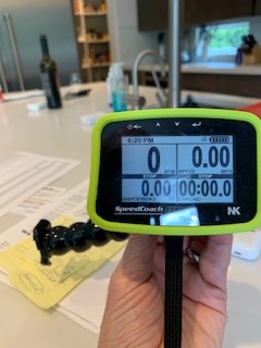

I've been using a Nielsen-Kellerman SpeedCoach,  The bottom two windows can be programmed for a variety of options.  It has workout options for creating and then running intervals.  Heartrate is one of the options but you need to buy a bluetooth chest strap.  There are mobile apps for uploading the data, which is very rich in intervals per 0.1 miles.    It's not a cheap piece of equipment at $399, but I guess some of the garmin watches are getting up there now. I attach it using a plastic arm for a gopro I got on Amazon.  The only thing it does not do easily is upload to Strava, if that is important to you. I use the Rowing Coach app on an apple watch to do that.
6 years 3 months ago - 6 years 3 months ago #36291 by mattbroad
Last edit: 6 years 3 months ago by mattbroad. Reason: forgot to attach pic
6 years 3 months ago #36292 by Epicpaddler
Nice.
Pretty sure I could see that screen mounted on the footstrap or forward in the cockpit somewhere.

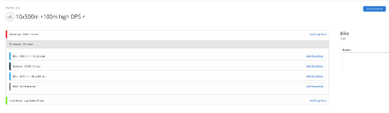

Can you program a session into it? Thinking of internal sessions, where you might do 1, 2,3,3,2,1 with 30s rest, or 4x4 with 2min tempo.
6 years 3 months ago #36295 by SpaceSputnik
They just record your data, they don't tell you what to do. You can program one of the buttons to end a lap which will give you stats for that lap separately but that's about all I can think about.

6 years 3 months ago #36296 by pprin
The newer Garmins do all you to program in fairly complicated interval sessions in the app and then send it to the watch.  You only need to create the session once.  The watch will then provide alerts when you approach the start and end of a particular piece/repeat/rest.  You can also set it to alert you if you fall outside of a set speed, cadence, or heart rate range.  An example screenshot is attached.
