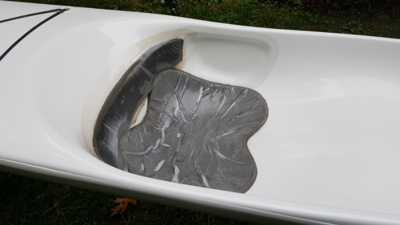

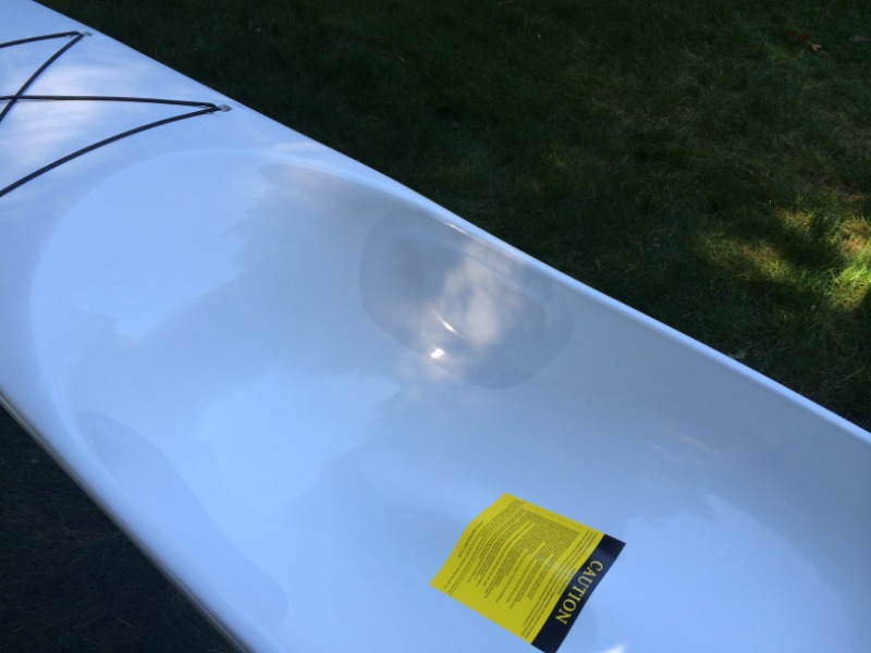

Like Zach mentioned, I've had to "cutout" a few boats. Here are some pics of my V14 modified bucket. Was a lot of work, but functions very well for me. I barely fit with this mod in the V14 since boat so narrow, but other skis gave me plenty of room (V10G1, Nelo Oceanski, Stellar SE).
Good Luck!
Chris
