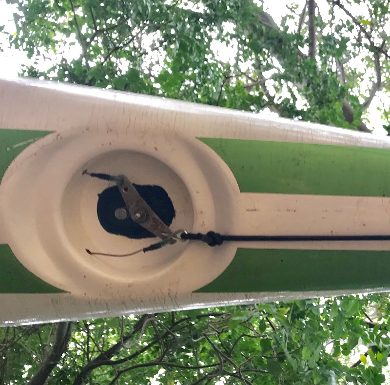

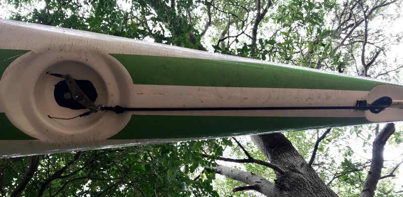

You could use a bungie (elastic) to provide tension on the rudder so that you can steer just with one rudder pedal.
Here's a couple of (horrible) photos of the setup that I created for my Evo II - as a safety measure in case of rudder line failure. You can see the bungie attached to the handle on the tail of the boat. It's hooked on to one side of the rudder bar so that there's tension on that side. So now I can steer using the rudder pedal on that side only, pulling against the tension of the bungie.

8 years 2 months ago #31474 by Kennewby
Thanks Rob.... Interesting thought the bungie...
