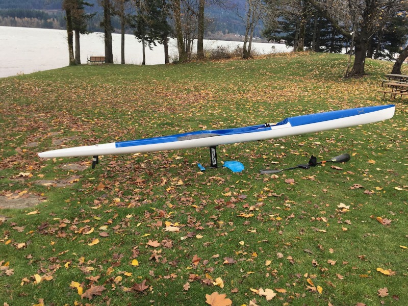

5 years 4 months ago #38119 by waterbornewarrior
Replied by waterbornewarrior on topic Foiling Surfski?
A few years ago I did a bunch of downwind runs in the Columbia Gorge, on 3 different boats, and a bunch of different wing / wing configurations.  I was hopeful that a typical foil configuration (borrowed from kite/sail/SUP) would work on a ski, but it doesn't.  I did achieve regular, brief flights, and speed while not flying wasn't terrible - I could "hang" with other surfskis.  The stability gained from the wing is tremendous.  It slows any roll to ridiculously low levels.  That said, it's also difficult to counteract any roll, but adding knee straps (like a waveski) helped.  It was possible to extend flights by "pumping" - throwing ones torso forward and back - but very strenuous (like doing crunches as fast as possible with a bunch of extra resistance!)  The fundamental problem is that when a ski is in position to achieve lift-off, the wing is in the wrong position relative to the wave, and/or you can't maneuver to maintain the correct position (due to the ski's length and "swing weight")  You can pop up, but either fall right back down pretty quickly, or zoom down into the trough and crash that way.
I think "sit down downwind foiling" may be possible, but probably not a typical surfski platform.   Look at how SUP boards have evolved, from slightly modified boards, so now being un-recognizable from regular SUP boards (just a "patch" of material big enough to stand on).  It may take some out of the box thinking, and some resources (time, $$).
Flatwater foiling (yawn) is a completely different problem, and I suspect there are viable solutions.

5 years 4 months ago #38122 by waterbornewarrior
I don't think a bow-mounted foil works in a downwind scenario.  (It may be great or even necessary for flatwater foiling, as shown by the Flyak.)  At the point where you're able to take off, the bow is out of the water, and once you pop up the bow is way out of the water.  You wouldn't want anything there - weight especially, or anything to catch the water.
Yaw didn't seem to be a problem... I wasn't really worrying about it, and certainly don't recall yawing all over the place.
Every other foiling craft works in the Gorge.  Once you're up on foil, the exact nature of the waves isn't a big issue.  It's just a matter of positioning (maneuvering) and timing.  The SUP foilers are going faster than surfskis, which shows that foiling is a completely different mode than displacement (you don't have to push a hull up / over / through anything).  The skilled SUPs aren't even using a paddle any more (SUs?) - either stashing it, or using it as an action cam extension.  Here's a good, recent example:
The following user(s) said Thank You: Charivari

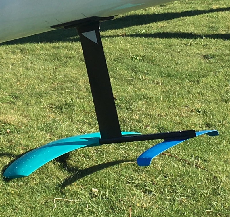

5 years 4 months ago - 5 years 4 months ago #38125 by waterbornewarrior
tve wrote: Interesting! Thanks for the explanation. Did you just use a foilmount stick-on mast mount or lay up a bit of a pressure diffusion plate under the surfski (also to flatten the area)?
I built a carbon plate (20 layers!), molded to hull on one side, and flat on the other for the pedestal mount of the mast.  Good enough for testing, but a flush or recessed mount would be much better.  You can kind of make it out in this pic.
Last edit: 5 years 4 months ago by waterbornewarrior. Reason: mis-quote

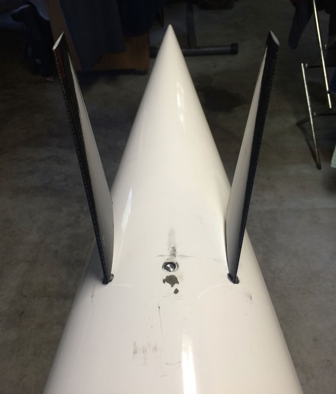

5 years 4 months ago #38126 by zachhandler
Replied by zachhandler on topic Foiling Surfski?
Is that a forked rudder on the back of the foil ski?
5 years 4 months ago #38127 by waterbornewarrior
zachhandler wrote: Is that a forked rudder on the back of the foil ski?
Haha, good eye, Zach.  It had nothing to do with foiling, just happened to be on that boat.  Like nearly everything I've tried, it worked.  But not better than a standard rudder.
5 years 4 months ago #38128 by tve
Replied by tve on topic Foiling Surfski?
waterbornewarrior wrote: I built a carbon plate (20 layers!), molded to hull on one side, and flat on the other for the pedestal mount of the mast.  Good enough for testing, but a flush or recessed mount would be much better.  You can kind of make it out in this pic.
Very nice, that's a lot of layers! I just ordered materials to make a ~42" long plate with ~36" long rails so I can really experiment with different foil configurations. I know you say that a foil in the front wouldn't work but I'm not sure that's true for ocean swell, and I think in the end there's only one way to find out...
Any recommendations for which types of foils to try/avoid? I'm eyeing either a 2450cm^2 low aspect or a 1800-2000 cm^2 high aspect.
