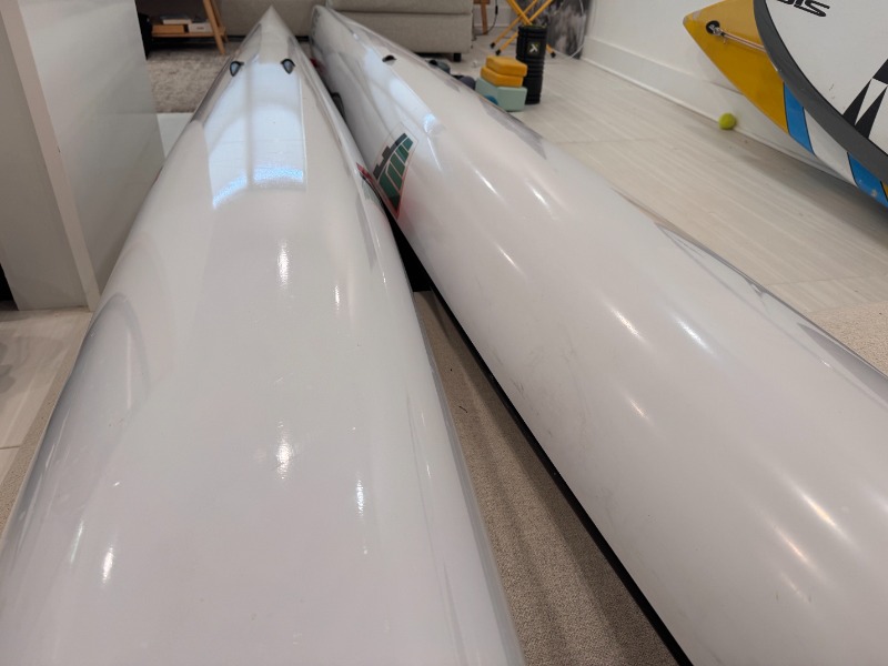

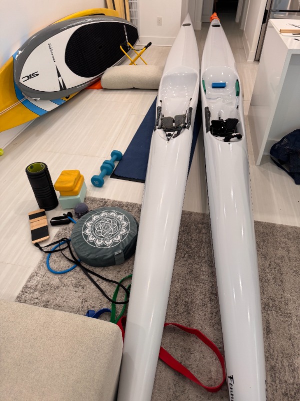

I’ll have more impressions of the boat when I take it out in bigger conditions especially downwind conditions, but for now here are my initial thoughts. Also, I took some dimensions and photos for your review.
Keep in mind that these are not perfect dimensions or weights and are an approximation. It’s hard to measure and weigh the ski exactly.

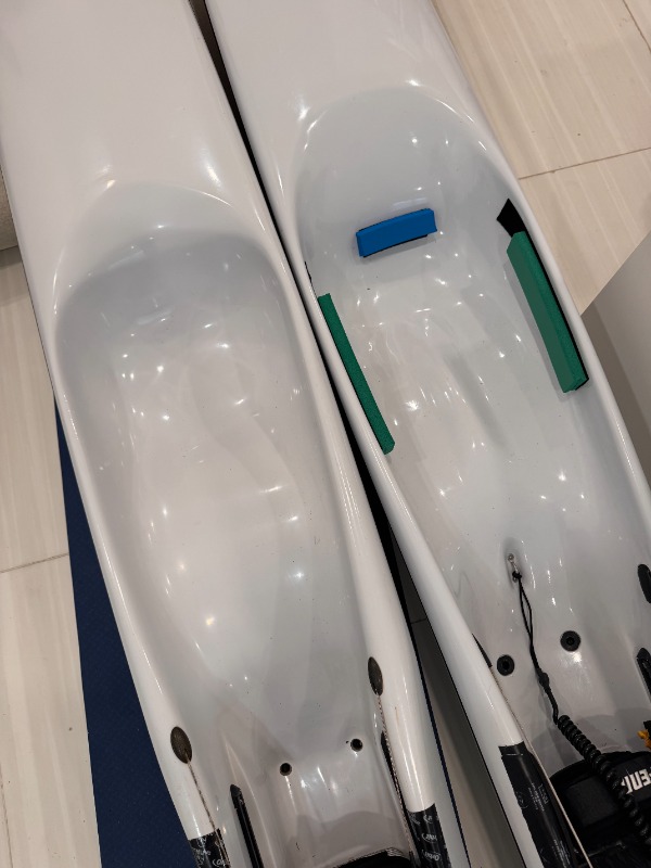

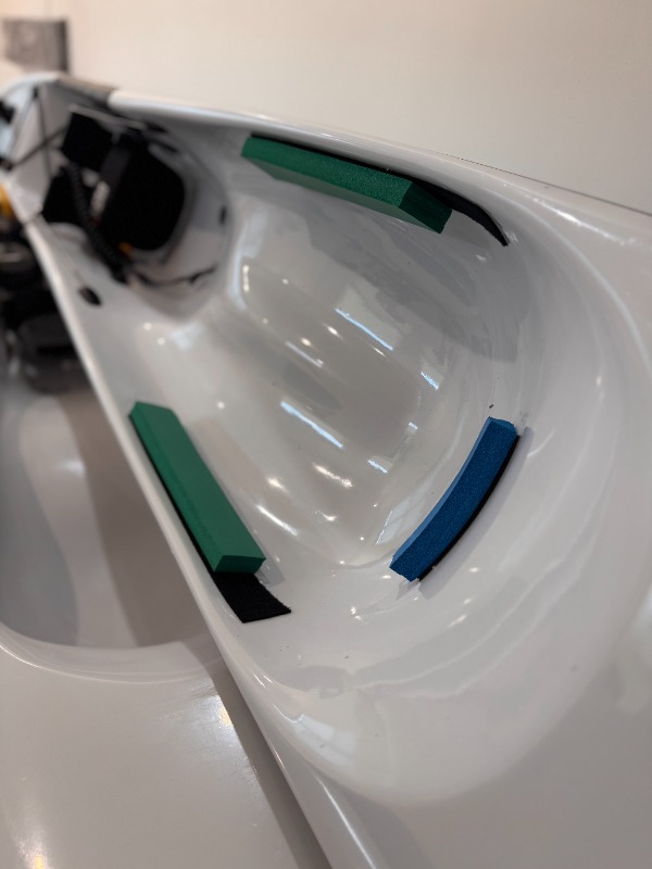

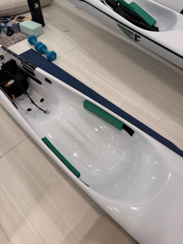

1 year 1 month ago #41304 by pilotdov
I measured the seat width of the CUDA, and it is about 1/4" less than the old Spark. I've attached some photos of what I did with CUDA to help me stay more centered. The blue cushion serves as a reminder to maintain a forward posture with a positive angle and avoid letting my back come into contact with the boat. I had a misconception for a long time about leg drive, that I had to make contact with the back of the bucket, but what I have learned is to lean forward instead, keep the foot strap tight and maintain that connection with the footbrace in both pushing my foot into the footbrace and simultaneously pulling back with the opposite foot with the top of my foot against the foot brace strap. The small cushion in the back is not intended for leaning against, but rather to make contact with the back of the boat softer; it's a gentle reminder not to touch the back of the ship. By the way, the CUDA, unlike the new or old Spark for that matter, has a slope in the back of the seat, and every bit of it is needed for surfing short big short bumps. Once employed, that slope helps one lean back and keeps the nose from pearling. Without it, the nose pearls a lot as compared to other skis with more nose volume, like the Swordfish. Even the new Spark has more nose volume, so it does not need that slope. Therefore, the foam I am using is very soft and allows it to easily compress when I lean back after catching those shorter wavelength waves. The foam on the sides helps keep me centered and more connected to the boat.
