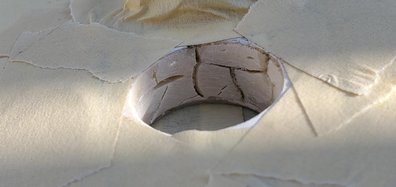

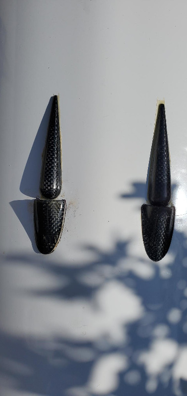

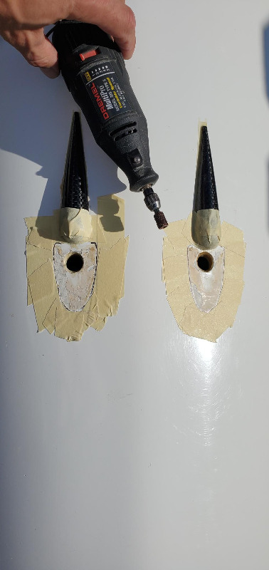

SO I ended up prying off the venturi's. They came off suprisingly easy with a thin putty knife. I mean, it took some work but they came off pretty clean in the grand scheme.
My venturi's were clogged with epoxy from previous repair attempts. I've cleaned that out now!

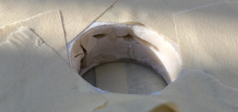

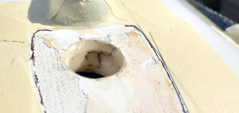

Even before doing anything to the drain tube area I oculd see cracks in it. THe biggest is shown in a pic below.
I taped off the area, took a dremel with coarse sandpaper and sanded out the hole by 1/8" / 3mm per side enlarging it to almost the same diameter as the venturi cone
As you can see in the last pics, I was having leaks because the foam/cement crap under the bucket is crumbling!
@Ranga what's the best method to repair this? I was considering taping off the bottom tight to the hull, making a pool of epoxy in the drain hole from the top, then carefully suck air out of the hull to pull resin into the cracked matrix of foam cement crap and hopefully create a strong water tight seal. After I've sucked epoxy into the cracks, I would let it gel, then add a single layer of 6oz carbon cloth to the perimeter of the drain hole to further reinforce it.
ANy better idea?
5 years 1 month ago #38568 by sarzelopez
I would  mask it generously and work from the bucket instead the hull, get a dowel or something, rolling it along the hole pushing some super paste into the crack until it oozes back out so it's completely full. Then closing the hole completely with the same paste before it gels and drilling it open the day after.
Or doing as you said but ending again with more epoxy, closing the hole completely.
I think trying to add glass on that small of a radius would be sorta weird and it might suck some epoxy out of the crack
We have a tendency to solve everything with the PC Super Epoxy here. Damn that thing never fails

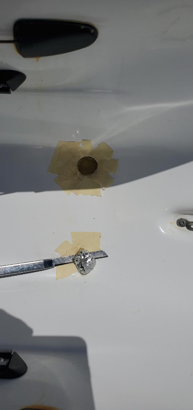

5 years 1 month ago #38569 by MCImes
Replied by MCImes on topic ^%#&* bailer leak (3rd time!)
I proceeded with my plan it so far its worked perfectly.

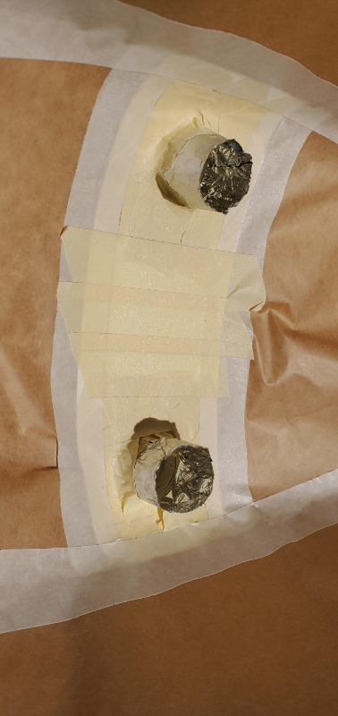

I taped tight across the bottom of the hull.
Flipped the boat over, taped off carefully around the bailer holes

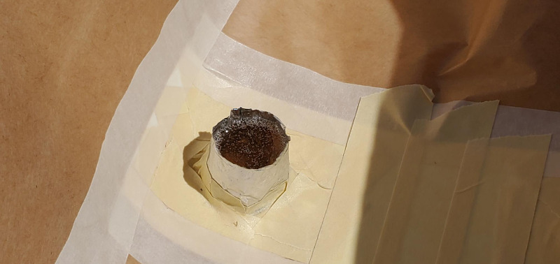

Then I took Aluminum Foil tape (the stuff used for HVAC ducting) and made a riser cylinder. I taped the riser to the previously taped perimiter around the hole with more masking tape.
I mixed 12g of West Systems 105 epoxy + 205 fast hardener and poured it in the riser. 12g was only enough to fill one riser flush with the hull, so I mexed 24g more epoxy and put half into the empty tube and double filled the other side, which had the significant cracks.

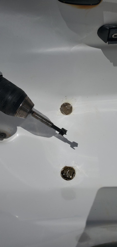

I let the epoxy heat up in the sub to aobut 70f, then let it sit in the cup for about 2 minutes before pouring in. When epoxy sits in the cup as a large mass with, low surface area it begins to heat up and cure very quyickly, due to its exothermic reaction. I intentionally let it heat up like this to speed its curing once poured, as even the fast hardner can be liquid for a half hour if its cool (<60f) and spread out (like  when glassing fabric). I wanted it to cure fast.
I inhaled a half breath through the vent hole and epoxy rapidly sucked into the cracks. I saw it happen and relieved the slight negative pressure.
The epoxy continued to run in slowly over the next 5 minutes before it finally gel'd and quickly cured.
After about 10 minutes it had a hard crust and after about 30 minutes i sliced off the chimney left behind by the over-fill. at aobut 30mins in the direct sun it was fully hard, but not final-cure hard. I was able to cut through it with a thin utility knife. If it went any longer, it would have been impossible to cut through and would have required grinding, which is much tougher/more messy.

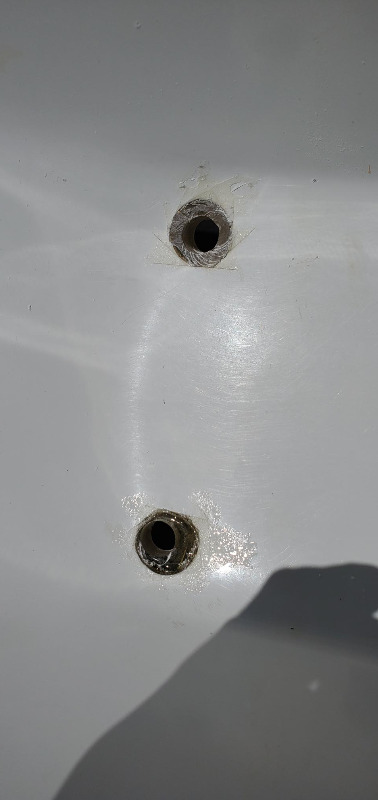

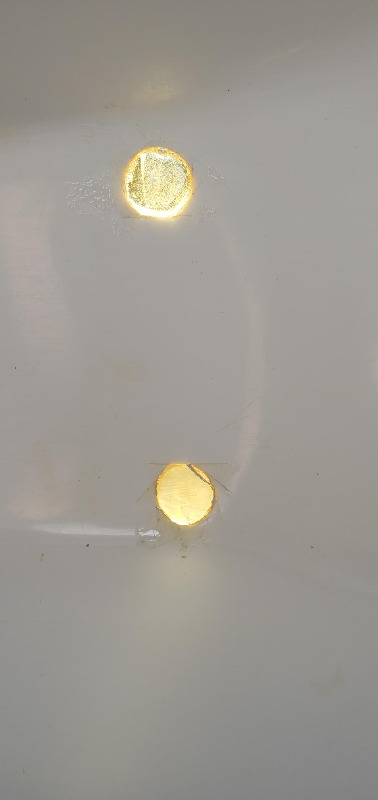

I let it cure in the sun for another hour. Then I took out my 1/2" counterbore bit and drilled a 1/2" pilot hole.

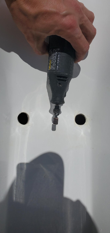

Next I used the dremel tool with coarse sandpaper to enlarge the hole so there was just a little epoxy left surrounding the enlarged hole, about 1mm / .050" per side.
Now Im letting the epoxy cure out fully. This evening I'll use some 1 minute epoxy to re-attach the venturi cones and take her for a spin tomorrow to see if she's finally water tight!
Overall this fix took 3-4 hours in all, but was not very hard. Hopefully this works as a long term fix. I'll report back as time goes on with the results

5 years 1 month ago #38579 by Ranga
Replied by Ranga on topic ^%#&* bailer leak (3rd time!)
I only saw this today but there was a much simpler way to repair, I have done many of these. Basically drill out hole 16mm and insert 16mm SS tube and epoxy in with West 105, all from the cockpit.
You are quite mistaken to think the laminate is epoxy, and yes epoxy will seal the laminate however they are not epoxy so all bets are off when the gelcoat is cracked.
