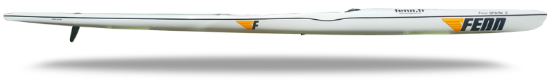

Just saw a photo of a Fennix Spark S in France. Anyone know how it's been tweaked ?

Would also be interested to hear of Fennix Spark S.
Anyone tried it out yet.
Have attached photo from Fenn French site.
