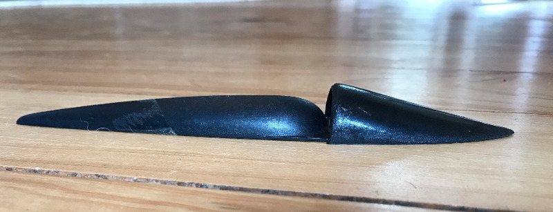

I'm new to surfskis and recently picked up a FENN Swordfish S. One of the venturis is  badly damaged around the open edge--boat probably got set down on a hard surface/rock and busted it.
Where can I get a new one and how do you get the things off and what's the best way to re-attach one?
Hopefully Ocean Paddle Sports will be able to help you with the spare part.
Probably the best approach is to grind the damaged scupper off and epoxy the new one on.

I called oceanpaddlersports.com and they actually had one carbon FENN venturi cover and are sending it to me free, so that's nice. Prob helped that I made another order (spare rudder cables, carbon bullets, etc.) and have spent quite a bit there lately...! :)
I've found some other info on this site re venturi cover placement relative to the hole in the hull. One drawing showed the opening of the venturi cover 7mm aft of the back edge of the hole, but another showed the opening of the venturi cover even with the aft edge of the hole. But it looks like for the bullet placement, generally folks agree that the forward edge of it should be placed near or into the venturi cover so there's 5-6mm of space between the the two around the circumference of each.

6 years 4 months ago - 6 years 4 months ago #36132 by jmden
oceanpaddlersports had one venturi cover left that they included in my order for free! Nice folks down there. Along with spare rudder cables, etc., I ordered their carbon bullets. So, it was grind off the busted venturi cover, then do a little gelcoat layer/fix as I managed to just nick the composite. Then I used 3M Marine Adhesive/Sealant 4200 Fast Cure (have used this stuff for years for all kinds of kayak/marine applications and it is amazing how well it holds up)  to attach the new venturi cover and the bullets after roughing up the gelcoat in those areas and a quick acetone clean up of all surfaces. 24 hr cure and out to the lake.
A big difference was noted. At mild cruising speeds, the boat was draining and then the gurgling set in. Only time I've seen/heard that before was when I was actually surfing a wave. So, at this point, this relatively cheap exercise seems to be working well. I can't measure the drag reduction, but if the hydrodynamic engineers are right, my two venturis with bullets should not be producing less drag that one venturi with just a cover. Seems good all around.
