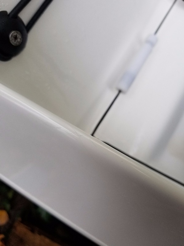

8 years 8 months ago #30234 by HangTen
I recently purchased a new Epic surfski in Club layup. Took it for a spin for the first time on flat and briefly through 1 foot chop. While wiping it down I noticed some fine hairline cracks on either side wall near the front of the bucket. Don't know if they were there at delivery because they are very fine. Boat was transported on Goodboy V-bars.
Is this typical of the layup or a manufacturing defect I should try to warranty out? Haven't had opportunity to meet up with the local dealer yet, so any advice/info is appreciated. Thanks.
8 years 8 months ago - 8 years 8 months ago #30235 by AR_convert
Back in around 2010 I had the same thing on a club spec V10 L within a few months of buying it.
I believe it's just the gel coat cracking with movement, not the actual structure of the boat.

8 years 8 months ago #30242 by Ranga
It is not normal to have hairline cracks in a new ski.
They did have a small issue many years ago when they first made the Club construction. They used the same gelcoat as the other sandwich construction epoxy skis but found the gelcoat was too stiff for the more flexible fiberglass polyester construction, hence with flexing you would get hairline cracks at certain areas.
Epic should have no problem having a look at it and either repairing or replacing the ski. Obviously they will have to try ascertain if there was any abuse to cause the issue or if it is a factory fault. They are usually one of the best when it comes to these sort of warranty issues.

Would repair consist of removing all the gelcoat and reapplying or just patching up that spot; the consideration being that if they repair that spot would other areas also crack later from the differential flexing?
8 years 8 months ago #30244 by Ranga
No, that is unlikely they would use the same gelcoat, not the way they operate.
As for repairs, you would secure the area with a composite repair properly and then finish off with gelcoat. No point in replacing the gelcoat if the underlying substrate is flexing causing the cracks.

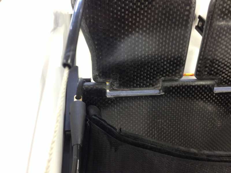

8 years 8 months ago #30246 by RichardCampbell
AR_convert wrote: Ranga is a composites repairer and is very knowledgeable on ski contruction/layups.
Hi Ranga
A quick question on Fenn Surf ski's (Elite S), If i wanted to put in a leg leash attachment point in the footwell, Is the best spot just as the footwell starts to go up towards the leg hump. When i tap in that area it feels really hard.
Any information would help greatly.
Richard Campbell
8 years 8 months ago #30247 by Ranga
All skis are hand made, there might be a flaw in that area. Usually there will be more cracks if it was inherently soft. These skis have been made for over 10 years so there is nothing inherently wrong with the construction, I even used the same Club V10 Sport for over 2 years, and yes it had a few hairline cracks over the years but then I did go through surf and big conditions. It however did not leak at all.
As for a leash attachment on a Fenn. That is a no-no. Unless you are going to reinforce the area of mounting quite substantially with a plate on the inside I would not try. The laminate is less than 3mm thick. Your best bet is to tie it onto the rail for the foot plate, they are attached with plates on the inside. Just loop through one of the holes in the rail.
The following user(s) said Thank You: HangTen
8 years 8 months ago - 8 years 8 months ago #30248 by RichardCampbell
Ranga wrote: As for a leash attachment on a Fenn. That is a no-no. Unless you are going to reinforce the area of mounting quite substantially with a plate on the inside I would not try. The laminate is less than 3mm thick. Your best bet is to tie it onto the rail for the foot plate, they are attached with plates on the inside. Just loop through one of the holes in the rail.
Hi Ranga
Thanks for the information, I have my leash tied around the mounting bracket between the slide on the footplate. Where this is one is attached
Thanks again
Richard

8 years 8 months ago - 8 years 8 months ago #30276 by HangTen
Cerca Trova wrote: A few years back I bought a new V10 Sport in Ultra lay up. About 2 weeks later I found sound hairline cracks and some soft spots on the bottom of the hull slightly forward of the foot brace. I sent Greg Barton a picture of it, and the 500.00 repair bill. I also stated that I could have possibly done it while loading, yet I didn't think so.
I said I did not expect Epic to pay the full bill, yet I would be very happy if he paid 50% of it. Within a week I got a check for the full amount. Needless to say I was stunned. I have bought other brands since then, though I do have a V8 Pro, and the new V11 coming in very soon.
Talking about customer service, are you kidding me!
Terry
Cerca, What's Greg Barton's contact info? I can't say my experience with Epic customer service has been positive thus far. Below are pictures of the hairline cracks on either side. Is this the typical quality of new Epic skis? Am I being overly neurotic/would most people accept it on a new ski?

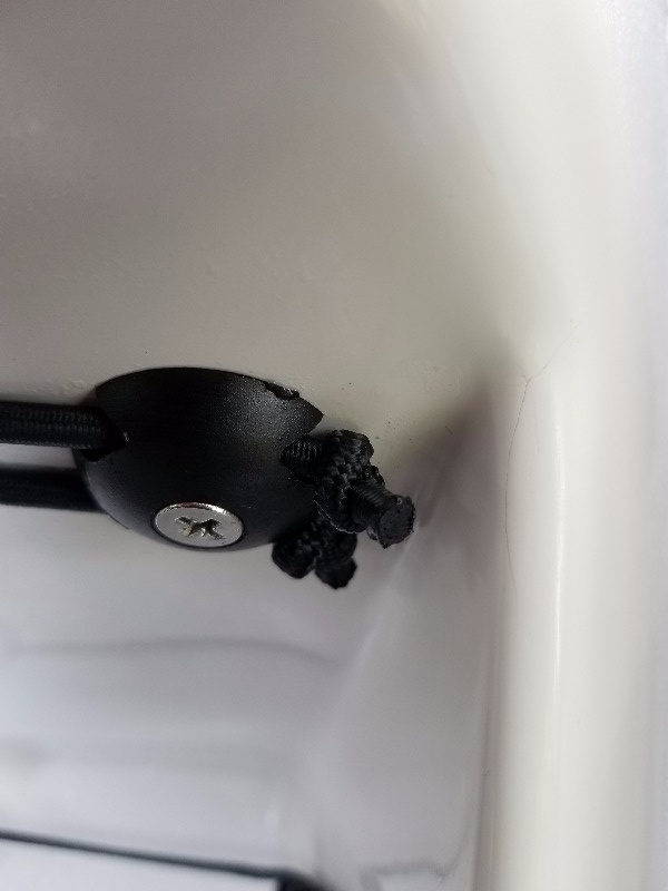

8 years 8 months ago #30285 by RichardCampbell
HangTen wrote: Richard,
If you like your brother's Elite S you should get one for yourself. I got confirmation from Fenn that the Elite S's all have stock built-in leash attachment point, so you shouldn't have to deal with modding it out.
Hi HangTen
I have purchased a 2017, Elite S, And unless the 2018 model has a leash point. Or they have the reinforcement plate installed that you can screw one too. Mine has no dedicated point. So I have attached the leash around the footboard like Ranga has suggested.
Richard
