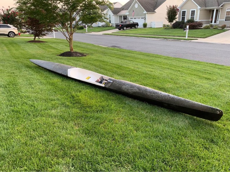

Can anyone tell me why the gel coat is damaged on this boat? And is it repairable? Is the boat functional in its current condition?

A close-up photo would be helpful.
My guess is that it is UV damage.
If the boat is cheap and you have the tools, it might be possible to sand back and re-gel-coat.
4 years 9 months ago #39055 by Epicpaddler
It's mostly like UV damage to the clear coat, which isn't gelcoat. It's probably the epoxy or whatever resin Epic used at the time to lay out the carbon fiber. I had a similar issue with a carbon boat. Local rowing shop said they could sand and re clear coat it but it would cost about $1500 USD. That was almost what I pad for the boat so I skipped it.

The ski has no gelcoat, this was the lightest ski they made at the time and if laminated properly with epoxy no gelcoat is needed. The downside is the UV stability, if looked after properly and stored indoors the ski would be fine for many years.
This one obviously not well cared for!
It will come up good if you are handy with your hands. There is a cheap fix or and expensive fix. Obviously expensive is to take it to the appropriate repairer and he will sand it down and professionally paint it with a Polyurethane 2K clear coat. Cheap fix is sand it down yourself with a 250 or finer grade paper, just enough to remove the damaged surface, don't rub the carbon, just the epoxy surface, You can either paint with a clear polyurethane paint with a brush or with an epoxy. West System 105 is a good epoxy and will come out looking quite good. I usually just use a plastic bondo applicator and squeegie it on. This works much better than a brush and keeps it very thin without any runs.
If done well it will look like new or very close to.

4 years 8 months ago #39161 by InTheSoup
I scraped off the flaking clear coat, did a light sand and then brushed on a thin coat west system epoxy!
Looks good from 15ft away which is good enough for me!
