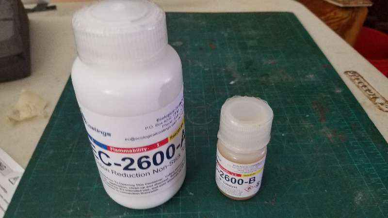

I'm experimenting with an industrial 'friction reduction coating' called EC2600  http://www.ecologicalcoatings.com/frictionreduction.html   It's a catalyzed water-based coating.   It's designed to be sprayed or rolled.  Since I don't have a sprayer and the seat is concave so rollers don't work, I brushed mine on.  Just got back from a 2 hour paddle catching powerboat wakes on Long Island Sound (salt water). There was no reduction in slipperyness, and no visible deterioration in the coating.  I used to paddle a Nelo Vanquish with a rotating seat, and the experience paddling my 560 with part of the bucket coated with EC 2600 is very similar.  Virtually no resistance to lower body rotation.  If this holds up it will be a game changer, at least for me.

.  Nick Patenaude responded and recommended the EC2600 This email address is being protected from spambots. You need JavaScript enabled to view it.. It is quite expensive.  I bought a 250ml 'trial kit,' which has enough product for more than 10 applications, assuming you're just putting it on the area where a seat pad would go.  It was $57 USD. So far I've paddled about 4 hours on salt water, and it's still slippery and hasn't visibly worn.  I'm careful to rinse it off before I sit down, so no beach sand, and I'm not on a brown river, so no silt in the water. I'm wearing Vaikobi VOcean lycra shorts, which I find grippy on the untreated polished gelcoat on both my boats (Fenn Mako6 and 2018 Nelo 560).

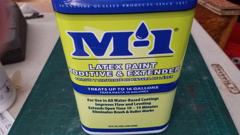

They recommend spraying or rolling it, but I brushed it, and that created fisheyes which I had to go over a second time with a damp brush to smooth out.  It really doesn't like that,  because it flashes very quickly.  I use a small scale to measure it by weight. I used 6gm product, 1gm catalyst, and I added .35gm additive & extender which did nothing to prevent fisheyes but did extend the wet edge slightly, and thinned the mix with 1.5gm water.
