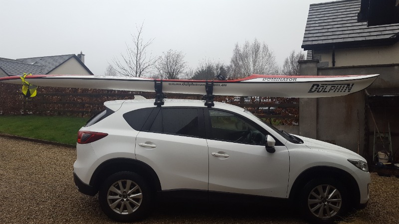

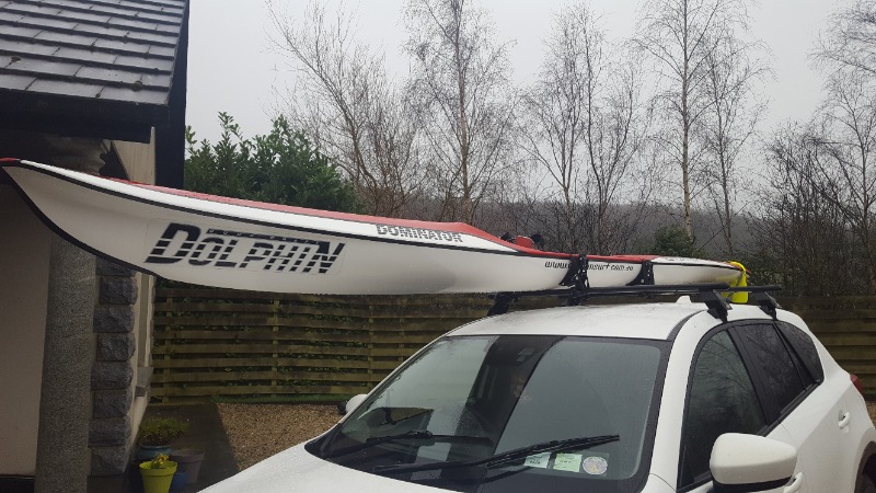

6 years 3 months ago #36107 by paddlepop71
Replied by paddlepop71 on topic Best roof racks
Thanks all. I went for the Ruk combi. They seem ok so far. How do I secure with the quick draw tie down for the stern and bow? There's no place to attach -just loop around??
6 years 3 months ago #36108 by TomVW
Replied by TomVW on topic Best roof racks
Looking good!!
Concerning bow strap: you can sew a loop out of a piece of strap and then tie that down to the hood, but be VERY careful not to over-tighten it, or you'll crack your boat in a pinch.
Personally, I do not use bow straps anymore: I don't see how a single bowstrap can stop your boast going sideways. It can stop it going up, yes, but your straps around the RUK combi are already doing that.
My Nelo 550 (OK, not very long) has never had any problem at highway speed with a pair of RUK COMBI placed at 1.2 m from each other.
6 years 3 months ago - 6 years 3 months ago #36115 by mcnye1
Replied by mcnye1 on topic Best roof racks
Paddlepop, I'd respectfully submit that your set up as pictured is marginal.  I am not familiar with Ruk, but the racks that I am familiar with recommend minimum spacing of 3-4 ft for kayaks.  The long length of a ski puts a lot of torque on closely spaced racks when subjected to any side loading.  From a math standpoint, doubling the distance between racks halves those loads.  This is why V-rack systems designed for skis have 7-8' spacing.  My first suggestion is to move the racks absolutely as far forward/aft as possible.  Secondly, on closely spaced racks, I would absolutely never drive far or fast without both bow and stern straps.  I agree with TomVW that a single strap does not accomplish much, which is why you need two on both bow and stern.  The lines should form a V with the boat and run to each corner of your SUV.  These things make securing the bow lines easy:  www.amazon.com/Seattle-Sports-Sherpak-Qu...83795260398859&psc=1.
I'd just tie the stern lines to the bumper.  As TomVW suggests, these lines should not be tied tight.  They are really just safety lines that will keep the boat aligned with the SUV if one of your straps come loose.  My last suggestion is to move the ski back a bit relative to the SUV.  There is a lot of upward flow created by the front and windshield of your car at high speeds.  If you move the ski back, it will be subjected to less of that wind.  When I moved my boats further back relative to my truck, the wind noise decreased and my fuel mileage went up.
One last comment regarding use of bungies to secure skis to a V-rack.  For long distance trips with the boat on the roof, I always have used a strap as back up to the bungies (2 per V).  For short trips or with the V-rack on the trailer where it is subjected to less aerodynamic loading, I have not used safety straps.  Yesterday I used the trailer and was surprised to find one of the bow bungies missing when I got home after a short drive.  Not sure what happened, but clearly they can fail.
