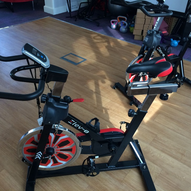

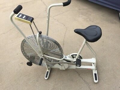

Gday, looking to knock up a ERG to get me through winter and was wanting some opinions on how best generate the resistance? Im looking at either a heavy flywheel and use some friction to slow it or use fan resistance. Ill be hacking up a old exercise bike for either and mounting it on a frame with some sprag clutches on either end to deliver the drive.
Which one do you think would give the closest feel to pulling on the water?
