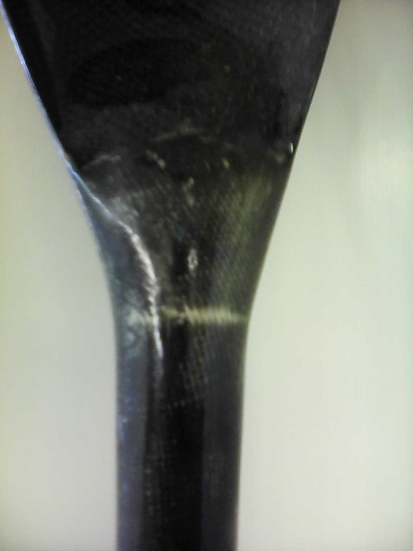

My experience says the simple answer is, yes. I have a paddle that developed cracks closer to the neck from what I would consider to be, maybe, harder than average use. I reinforced it with epoxy, fiberglass and cabasyl, but, as you can see in the picture below, the crack reappeared. So, this paddle is not might first choice to use on a serious downwind. I also snapped a blade, in the same area you are describing, while being drug toward the beach locked in my foot straps on a large wave.

My wing paddles have held up fine, but I've cracked various parts of my ZRE brand carbon canoe paddles on multiple occasions. I've crushed the grip, cracked the shaft just above the blade, and cracked the blade planting it down hard on a sand bar. All 3 times I've repaired it successfully.
If the crack has severed the threads of carbon, there is a weak spot and a catastrophic failure is likely to propagate from the small crack, as it has created a weak spot in the weave. Also, since its high up on the blade, there is a lot of amplified lever force on it, so I would say it is likely to fail without repair.
I'd repair the area with 1 layer of 6oz carbon cloth to ensure your paddle lives on. I attached my composite repair instructions for reference.
I'd avoid using fiberglass to repair carbon, because like Fath's experience shows, glass flexes a lot more than carbon and the crack may reappear because the carbon is more rigid than the glass. In general, I'd alwaus recommend repairing with like cloth (or in the case of Kevlar, use carbon because Kevlar cannot be sanded - glass and carbon can)

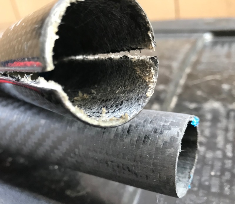

2 linear cracks from the inner edge to the base of the blade (right across from each other).
How would you suggest fixing this?
