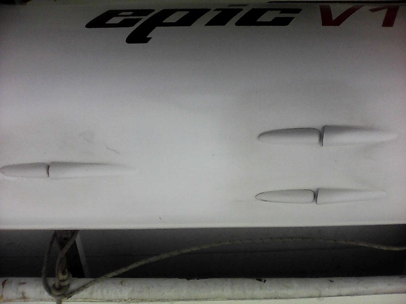

I modified my v10 with the Red 7 system to fix a very poorly designed and installed venturi. Haven't measure speed, but, the
system in the picture is silent, super effective and efficient. My other skis have more typical venturis with no bullets and make a lot of sucking noise as speed increases. So my conclusion is the silent venturis create much less drag then the noisy ones.
8 years 1 month ago #31721 by cogdoc
Nice work, is that a seat bailer? Awesome, be nice not to sit in a bucket of pee on longer runs. The gap between the bullet and the hood defines how much this system "sucks", and thus how quick it empties. The crappy bung system on my Stellar needs a bit of modification, my old ozflyte had small poly - tarp type flaps on the outside of the hull inside the bailer hood, and whilst not water tight, they whould impede water coming back in when you slowed / stopped. Best of all worlds that.

Thanks cogdoc. No, not a seat bailer just redid the orignal and added two new at forward end of foot well. I just splash a lot of water in the seat well when I pee.
