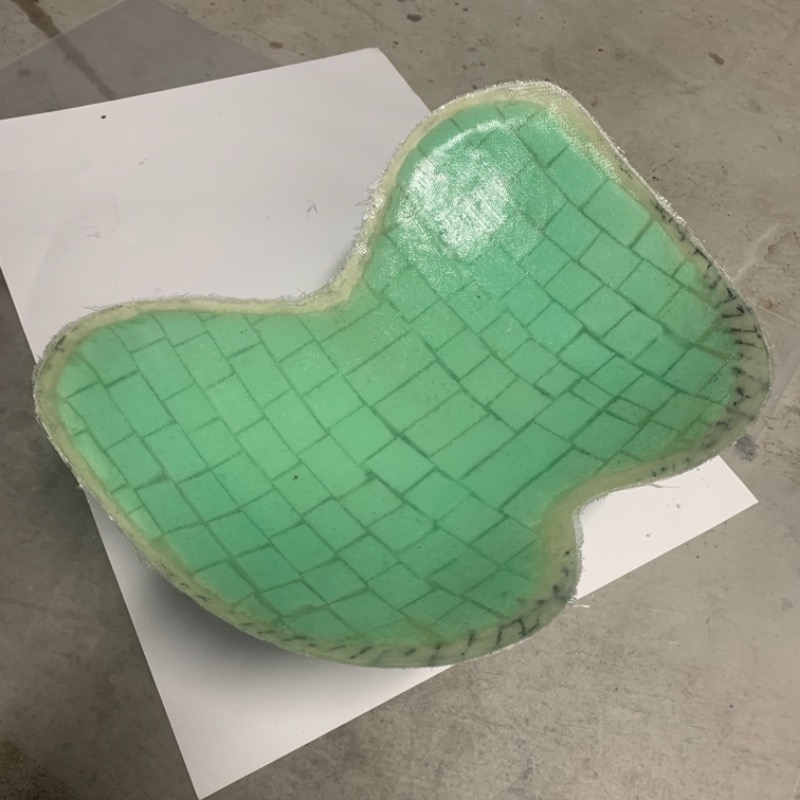

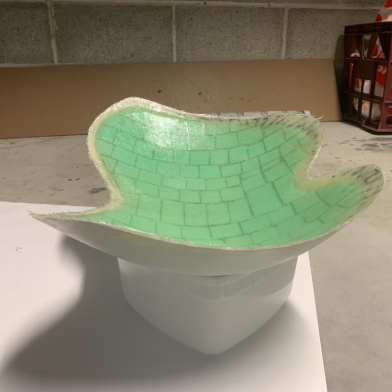

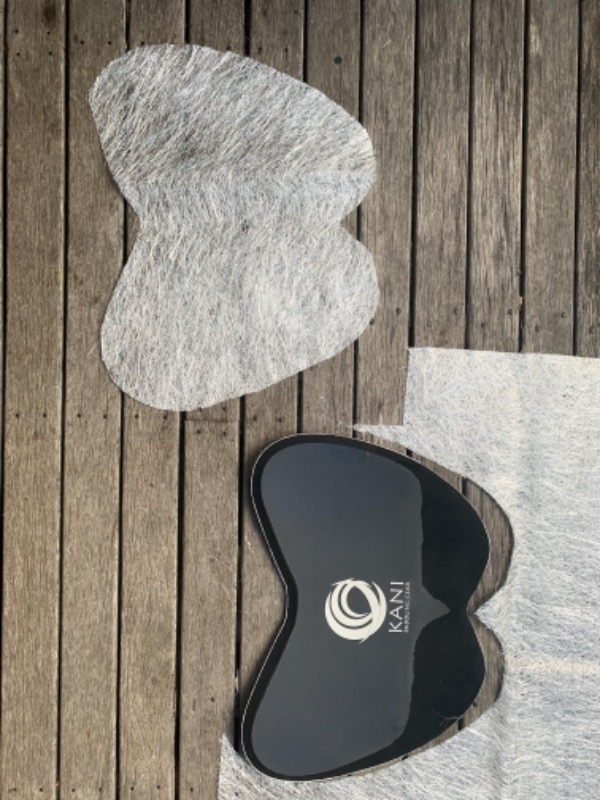

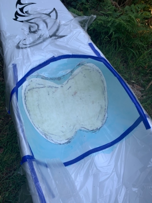

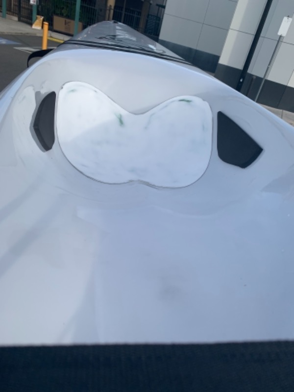

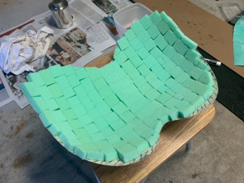

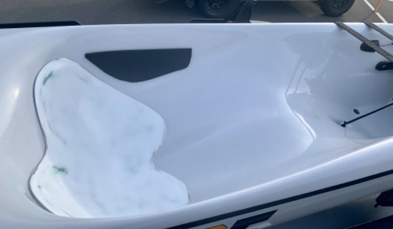

OK, i’ve finally managed to subscribe effectively and thought i might share my “journey” with the Swordfish S seat.
I’ve had the boat for about 18months and grown to really love and trust the hull and the stability profile. I started getting some pain in the buttocks/hammies at one point and decided to raise the seat with a foam pad. I at first went 14mm but the stability difference at the time was too great, so settled on a 10mm seat as a good compromise. I placed it towards the back of the bucket in order to achieve a little height and also to shift my natural “sitting position” further forwards. I have relatively short legs so this helped place my knee bend more centrally over the hump rather than bottoming out my calves. By tilting my pelvis forwards a little it also seemed to reduce the sensation you get with Fenn’s of sliding down and backwards in the bucket.
All this was very successful...for a while. My power and leg drive seemed better with the extra elevation. I then started developing a different issue with my lower back, and decided eventually that the foam pad, even with a fairly slick top surface, was bogging my ischial tuberosities down and inhibiting hip rotation, forcing some overcompensation in the SIJ and lumbar areas.
So... after a bit of research, I decided to embark on a custom fibreglass seat build. Using the outline of my foam seat pad I moulded a bottom layer using the Sworsy’s bucket (with lots of release compound....) and then built up a foam core and top skin. It is feathered from essentially zero height at the leading edge to about 10mm at the rear. It is placed at the rear of the bucket in order again to slightly reduce the rearward angle of the bucket from the hump back, tilting and lifting my pelvis. Because it is slick and hard, my rotation is retained.
All in all I am extremely happy with the outcome, and after a couple of months think it has transformed the boat for me. A mate with a swordfish S was also considering ditching it for the same reasons and felt it was like paddling a different boat when we A/B’d them the other day.
Downsides? It was my first attempt at fibreglassing, so the finish of the topcaot is not perfect, and it adds about 500g to the boat. If i did it again I’d use carbon and fewer layers.
You’ll also see some self adhesive foam at the sides of the bucket to provide some tactile proprioceptive feedback to my hips. I find this helps also with stability in unpredictable chop.
Pics below:

5 years 7 months ago #37768 by [email protected]
That's flippin' brilliant!

I find that a small foam pad can make a huge difference. 5mm-8mm thick and just filling the very bottom of the seat well. Duck tape over the bottom and edges and then UHMW tape over the top to make it slippery. Use some acrylic double-side tape to tack it down. Takes a bit of tweaking to find the right placement, but completely changes the feel even though it looks like nothing in terms of thickness. The way I would describe the feel is that instead of sitting in a well that inhibits rotation I feel like I'm sitting on a flat surface that lets me rotate easily. It also tilts my pelvis forward, helping me to sit upright. A friend uses a small wedge shaped pad in the back of the seat well just to tilt the pelvis forward.
The insert Dratz shows looks very cool! Besides being too lazy [...] I've held off from doing something like that because I've found that every few months I want something slightly different as my paddling improves. I wonder what the lightest construction would be...
