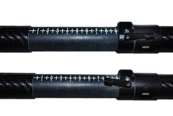

I own 2 Epic paddles. Both have adjustable shaft length. One has the new lever lock system :) but the other has the older twist lock :angry: .
Has anyone tried to retrofit an older paddle with the new lenght lock system ? Where can one buy the ferrule ?

Chad Meek in Victoria Australia seems to offer the same system ? .
I would think there was 3 ways to remove the current plastic adjuster
1) gently heat it the plastic till the glue holding it to the carbon softens without affecting the resin the shaft is made from (most risky) and pull it off whilst hot
2)saw the plastic on either side down to the glue(without slicing into the carbon) and "lever" it off
3) cut the whole plastic bit off and accept it will then be 3ish cm shorter
You would be able to use the fibre "spigot" in the other side.

the only problem you are facing here is that because it is an older version the ferrule will not come off, it is glued with epoxy. Replace the collar first and then use the same ferrule, just use the 0 degrees line on the old ferrule. the paddle length might change with a few mm as the old and new collar is not exactly the same size. Make a mark on your shaft next to your collar where the zero line is, this will help you when you put the new LL on so that you can find your zero degree mark. use a tube that fits into the collar, push the tube right through the collar so that when you put it into the shaft it keeps the collar from dipping to one side,remember to put release agent on the tube! if you need any help regarding the removal of the collar i will gladly help you step by step, cheers!

I had info from Pat (ONNO Paddles) : his lever lock system won't fit an Epic paddle since they use different shaft diameter. Have contacted Chad Meek and asked. Also contacted Bennett Surfboards . And I sent an email to Epic, altough their web site says they don't sell it, maybe if i ask Kindly B) ...

Answer from Chad meek : "It is unlikely that the lever lock will fit your current paddle the shafts do vary in inside diameter." :(

Bennett (www.bennettsurfboards.com/paddles/paddles.html) sent me a new answer : they don't sell the lever lock but they forwarded my request to Epic Kayak Australia (www.epickayaks.net.au/Epic_kayak_accessories.html) and guesswhat... They can sell and send me one ! Yeah !
