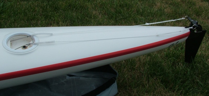

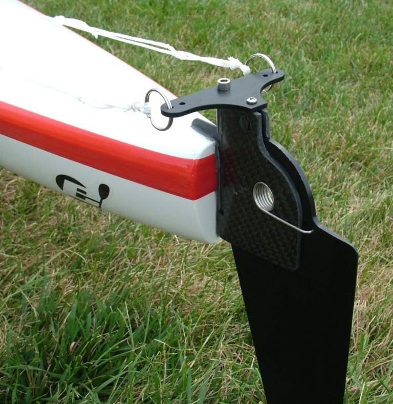

I got around to installing my Van Dusen over-stern kick-up rudder this weekend on to my Epic V10L. This is really a slick unit - simple, clean, and elegant. Installation basically requires the cutting of a slot in the stern of the boat, and epoxying the blade on the hinge in place. A long screw/hinge pin can be removed if the over-stern rudder isn't needed, leaving only a small part of the hinge sticking out of stern. For connection to my rudder cables, I removed the rudder assembly cap and tied directly to the cables. I may improve the appearance later by installing some tubing in the hull to keep the cables hidden (and allow me to replace the cap). In trials on my pond I noticed the over-stern rudder didn't track quite as well as the under-stern, but it responded well and seemed to turn every bit as tightly as before. This is a good option for those of us using waterways full of obstacles.

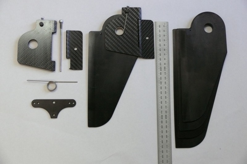

The first picture is from Van Dusen of the rudder assembly; the following pictures will be of the installed rudder assembly on my boat.
15 years 10 months ago #5185 by red_pepper
Installed on my ski.
15 years 10 months ago #5186 by red_pepper
One more photo.

Thanks! I think over the next few days I'll probably change to some better line (if I can find some stainless braided cable or Spectra) and retrofit the understern rudder steering bracket to allow convenient switching between rudders(There's a race coming up on Lake Michigan where I may want the understern rudder).
I took it out on a couple of linked lakes yesterday while we had some very stout winds (15 - 25 mph, gusting to 35 mph). With the cables tightened up a bit this rudder worked quite well, especially through the weedy channels, and seemed to work fine running down wind or upwind in the 1 ft chop, but I missed the authority of the understern rudders when turning around or running cross-wind. It was kind of fun hearing the "clunk" of the rudder as a patch of weeds would cause it to rise up and release.
