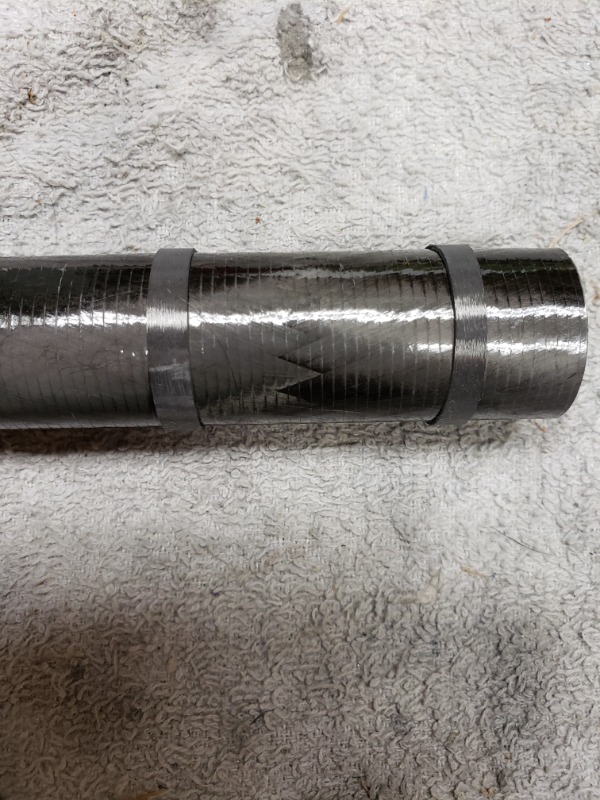

-21k is 28mm diameter, so Braca includes .5mm shims to glue onto the shaft before assembling into the blade.  Required to get the proper alignment as some folks have noted. Attached is a picture.  Once the shaft is cut to length, just glue these on with crazy or gorilla glue, let set, then assemble the paddle as usual with Braca hot glue.
