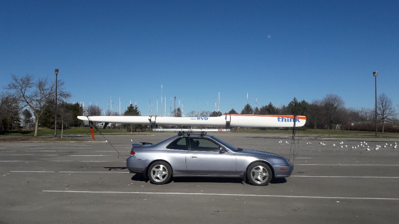

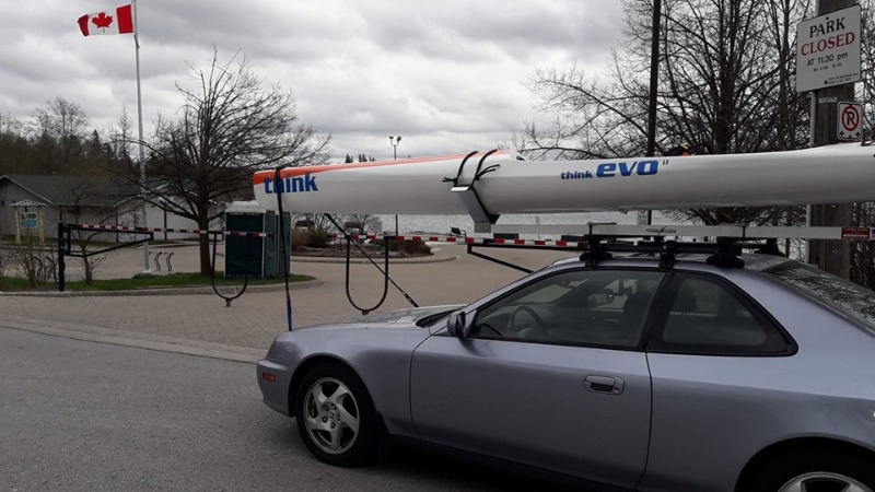

Here's what I have done in the past. The crossbars are spaced at 2 feet. Two independent tie downs in the front and one at the back. The V rack is Goodboy classic 7 feet.
Travelled long distance with no issues.
Without tie downs it's dicey, too much sway. With tie downs it travels fine. I now use my minivan because I hate doing the tie downs and the spacing on my custom rack is huge and it's just less hassle, besides my SES has to handles at all.
The base rack here is an Inno with a short roof adapter. The rear feet just rest on the roof and the rear clamp does not have a tower under it. Given this design, it's a pretty sturdy setup, but given the short bar spacing there's still sway that needs to be neutralized bu tie downs.
That rack setup was pretty pricey and I was lucky it was even available for that old car.

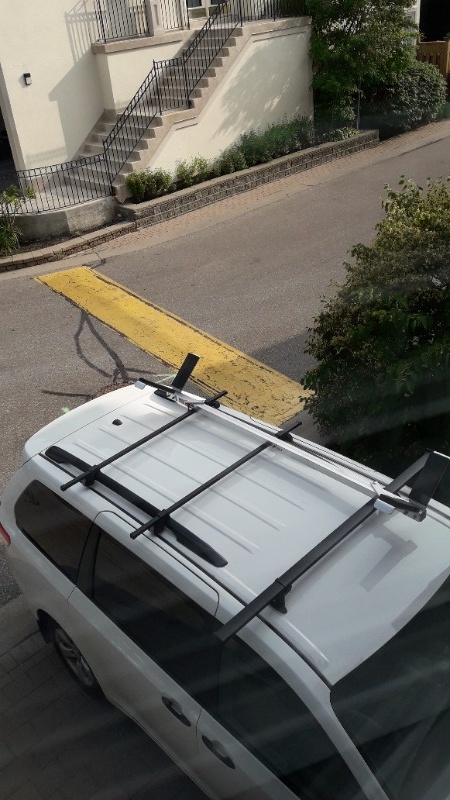

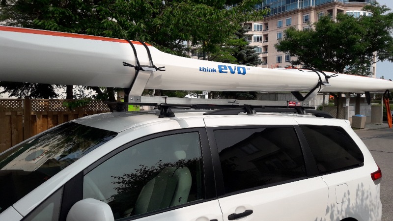

This is my van setup.

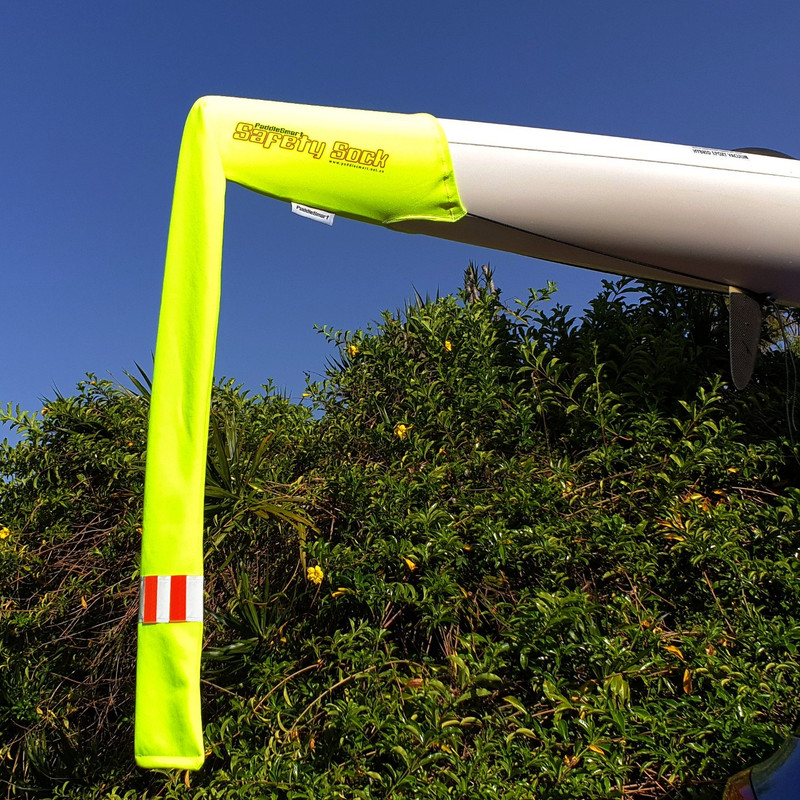

SpaceSputnik wrote: One thing to watch out for with a low car is people and other vehicles hitting the rear of your boat while moving at 90 degrees to it. It sits low enough for that. On my van it's not an issue since it sits way up there.
I never travel anywhere without one of these on the ski.  Unlike some other flags, they don't just hang off the rudder, they make the whole tail super-visible and they have red and white reflective strips on the tail so they really stand out at night.
Great for when you're reversing, - it's saved me damaging my ski on several occasions!  Cheap insurance.

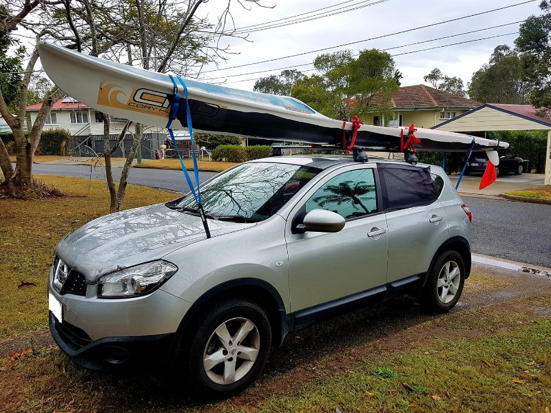

Replied by Crab Stick on topic Small cars/big boats
My Nissan Dualis
