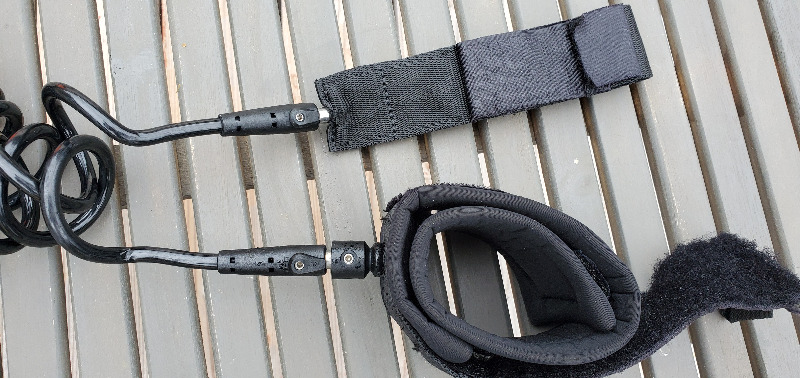

I had my own leash failure a couple days ago. The ocean was dead flat so I was surfing 2-3 ft (occasional 4ft) beach break. there were a few people nearby so I stayed leashed as not to have a runaway boat (that was the thought at least). I got some perfect surfing in, waves were great, curled extremely predictably and I was bailing off some near vertical faces as I approached shore (even the surfers were giving me props which never happens around here).
Well, as you would expect after ~20 laps I started to bail a second too late and the wall curled before I could get over the lip. I ended up perfectly parallel to the wave face just as the barrel collapsed on me, rolled me to the ocean side and I prepared to be drug along for a while, but the leash let go at the boat side velcro.
It was getting worn out and I ordered a new leash 2 days earlier, so knew it was dying, but it held up the a similar dump-and-drag situation last week. During that swim it stayed attached and drug me almost all the way to shore from 100+ feet out. I stretched my 10' leash by at least a foot or 2. Im amazed it didnt break.
Looking at Zach and TVE's broken leash, both use a rope-tie to attach the boat end to the coil. This seems like the weak point in the system. The leashes I always use have a swivel on both ends and the boat end is attached with a stainlees steel T that is woven into the webbing. During the dump-and-drag I was pulled so hard one end of the T started to fray through the webbing, but held up.
Basically, im saying I think the rope-to-coil attachemt method is less strong and inferior to the steel-to-webbing on leashes with double swivels. I have only used this style of leash, and is all I will buy going forward after seeing the rope-leash point fail in multiple examples.
The next thing I need to do is make an attachment point at the bow for shore break surfing so that the boat weather-vanes with the bow pointing to the ocean when I eat it (allowing for a fast remount and possibly making it outside the breakzone before the next wave). For open ocean I'll still use the bucket attachment point.
For reference this is a SUP USA brand calf leash. I found an identical one that's cheaper on amazon. Its sold out now, but was only $15 shipped vs ~40 for the SUP USA. www.amazon.com/gp/product/B07YDF1NS8/ref...01_s01?ie=UTF8&psc=1

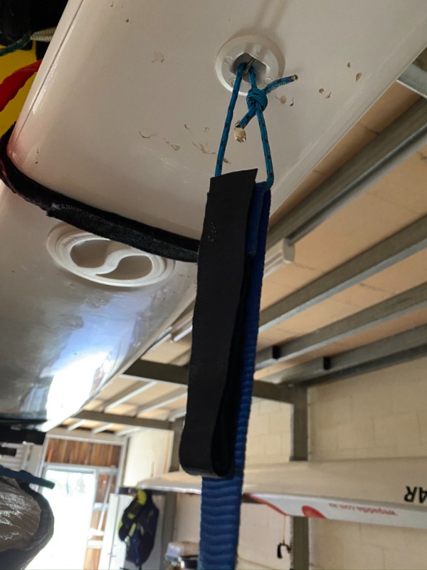

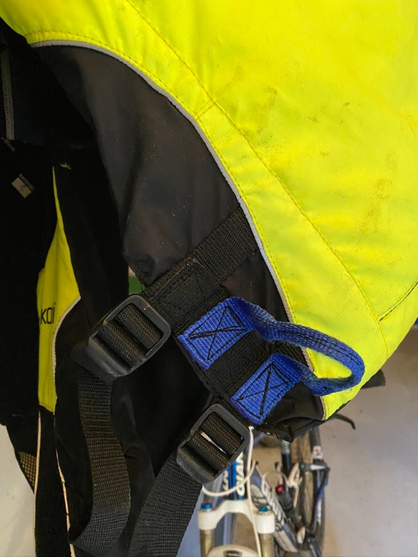

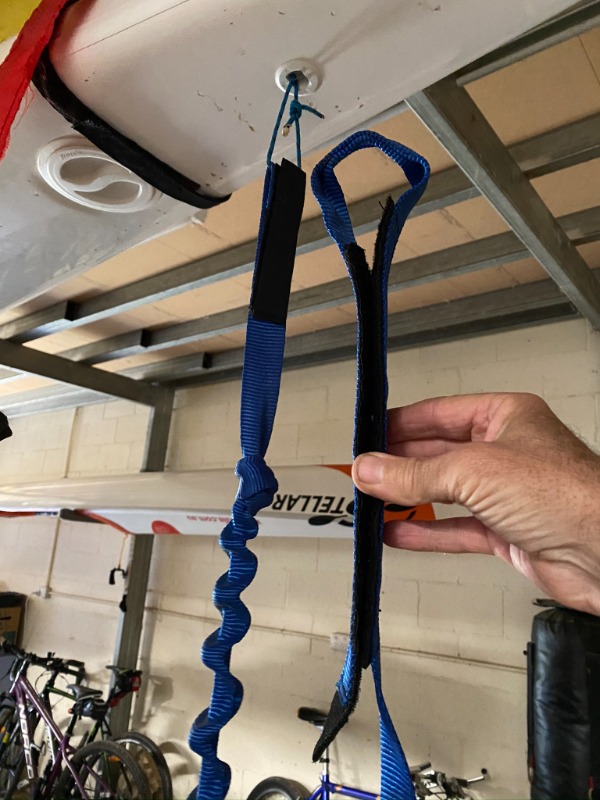

I have been using a leash from the stern of the boat attached to my Vaikobi pfd for a few years and would never go back to a leg leash for all the reasons outlined above. Thanks to La Perouse Bay for the initial inspiration!
I'm wary of the swivel attachment points on regular surf leashes and am fortunate enough to have an industrial sewing machine so came up with my own system.
Tubular webbing with elastic bungie inside, scrunched up and then tied off to give an elastic stretch but with solid load bearing webbing at full stretch.
Where the leash feeds through the loop on the pfd there is a large 50mm velcro overlap with a free tab on the end - quick release if required.
In earlier versions I used the small yachting quick release fittings but find them a little fiddly and have also managed to accidentally undo them with all the mucking around of a remount in reasonable sea.
To my way of thinking the  weak link is the leg rope attachment point that came standard on my V8 Pro - on other boats I have supplemented with and extra stick on leash point - boat surface properly prepared the 3M VHB double sided tape is incredibly strong. If I didn't have the standard leash attachment point on the stern I'd use two of the stick on ones.

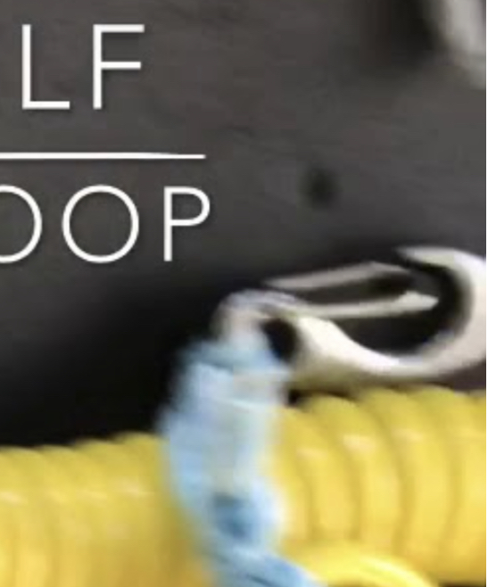

Metaleash looks very well made. But i still do not trust any quick release hardware. I have had 2 different quick release mechanisms on epic leashes and both would fail (one looks to be the same as the meta leash though hard to tell from the pics on their website). A friend had the mocke quick release, an entirely differently designed piece of hardware, and that too would fail. All behaved the same. All would be good until falling out of the ski. Then when going to remount i would notice with horror that the quick release had disconnected. Unclear if it had happened during paddling or during capsize. I had this happen more than once with each design. Fortunately i tend to grab the ski as i go in.
I don't mean to squash your enthusiasm for what looks like a very nice leash, but I do feel an obligation to point out safety issues that could get people into trouble. I eventually disabled my quick releases with wraps of epoxy soaked glass on one and multiple layers of heat shrink wire insulation on the other.

I dont have experience with the pmastic buckles. The piece that has failed me is the metal clip. Ill attach a blurry pic from their website
