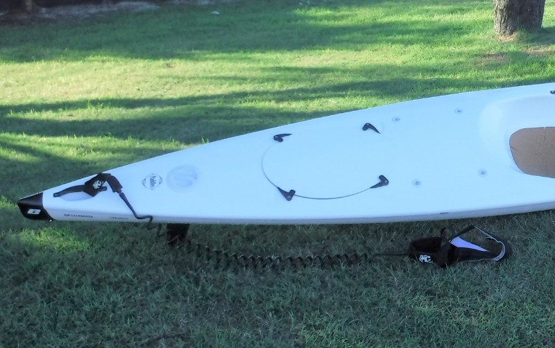

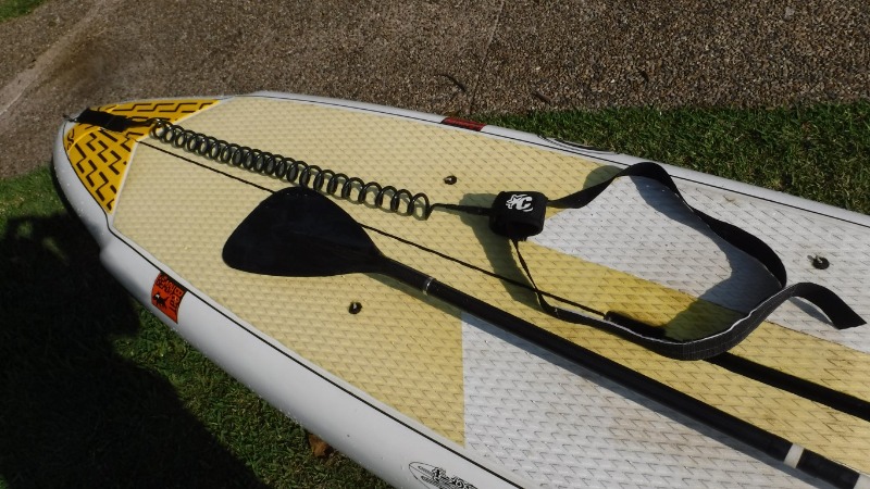

7 years 8 months ago #33014 by paddlepop
Replied by paddlepop on topic Why NOT a waist leash?
i've been using the same waist leash on my SUP for 2 years and on my V5 for 5 months and wouldn't go back to a calf or ankle one. it's simply an existing coiled leash where the ankle loop now has a length of seat belt webbing through it with long bits of velcro sewn either end. you just need a decent sewing machine (or a friend) to sew it up. Pete

7 years 8 months ago #33016 by paddlepop
as you can see in the 2nd photo above i was lucky to have a handle to attach the leash to. otherwise i'd epoxy on a couple of these pad eyes, link them with a loop of spectra/dyneema cord and attach the leash to that. there's actually some on my SUP in the 1st photo

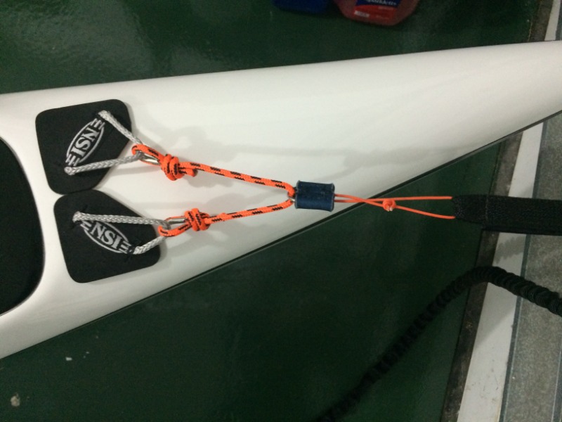

7 years 8 months ago #33029 by Wombat661
Replied by Wombat661 on topic Why NOT a waist leash?
I was afraid one might fail, so I used two NSI rubber plate with a load spreader line. Force should be evenly distributed between the plates. The knots were big enough that in case one fails, the other still holds the leash.
Rubber plate might conform better to a curved surface than a rigid mount. However, on a flat surface, rigid mount would be stronger...
One time in the surf, the waist strap actually tore off the velcro connection, and the mounts were fine.
Lesson learned from me was to put the anchor in front of the boat instead of the back so the boat can weather vane into the wave.
