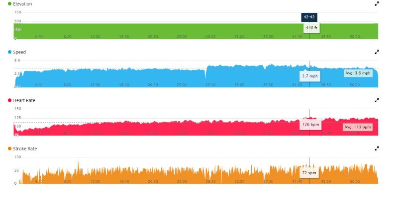

Mine has holding steady pretty decently. I think this link will work to one of my Strava logs?
www.strava.com/activities/1767045174/analysis
I use Garmin Connect as my primary and it is linked over to Strava. I also have been importing my sessions to rowsandall.com, but wow that site is data overload to me as a newbie.

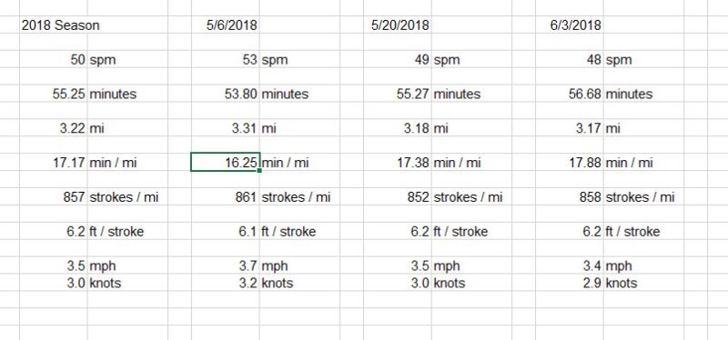

I did setup a "post-row" spreadsheet to calculate average stroke length, but an Excel file posting isn't allowed here. A screen capture is attached, but it is just the average for the session.

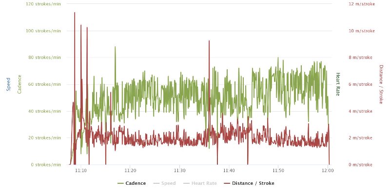

7 years 10 months ago - 7 years 10 months ago #32561 by eea123
I don't why I hadn't tried this before, (maybe because I don't own a Vaaka?) but I tried to upload a TCX session to their free Analytics. FYI, keep the session indexed as Cycling or it won't pickup SPM. I had edited mine in Garmin Connect to Paddling which shows SPM instead of RPM, but Vaaka doesn't like that and expects the TCX field as RPM from Cycling.
Vaaka's app calculated my Average Stroke Distance as 2.04m, but I calculated it as 1.91m. Maybe they are discarding some of the outliers, but that is almost a 7% difference.
from my Excel spreadsheet:
8/12/2018
51 spm
52.67 minutes
3.19 mi
16.51 min / mi
842 strokes / mi
6.3 ft / stroke (or 1.91 m/stroke)
3.6 mph
3.2 knots
Note: Garmin has the distance at 3.19mi and Strava rounds down to 3.18mi. That rounding is 1.91 vs 1.90, even worse for Vaaka's 2.04. 1m = 3.2808333ft right?
