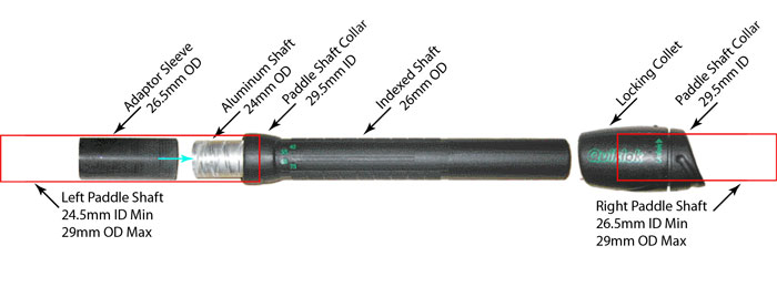

so I still haven't shortened my paddle but I got a new idea.
I'm thinking about making it a three part paddle.
If I just use a ferrule in each blade part,
just past where the hands go,
then I can have any length center piece for for the middle section.
I can even have several, depending on what type of boat I'll be in,
ski, kayak, pack boat or whatever,
or if someone else wants to try it out to get the exact size/length figured out.
Now I just have to find material for a couple of ferrules
and the center sections. Suggestions ? Suppliers?

15 years 11 months ago #4628 by Boof Head
www.clcboats.com/shop/products/boat-gear...-paddle-ferrule.html
Link above for ferrules but for the price of having a CF ferrule shipped you might find that a local kayak/surfski builder/repairer could sort it out cheaper.
I recently took one of my paddles with a smashed shaft to a local kayak repair shop and they replaced the whole shaft for about $40. it was just a fibreglass shaft but it was my old beat up training paddle so the miniscule weight gain and small increase in deflection doesn't worry me for the price I paid
15 years 11 months ago #4629 by spidennis
yup, those clc parts are pretty expensive! 57 bucks! and I wonder if they are the right diameter? and then there's still the shaft to get ....... but I'd suppose I could use my existing shaft and then it would end up being a 4 piece paddle using three ferrules ..... but I'd require two of them? 57x2= ouch!
or 38 bucks for the Quickloc
I don't have a local shop for this kind of work, but texas is a big place, and maybe some of the tws (texas water safari) folk can give a suggestion on a shop?
