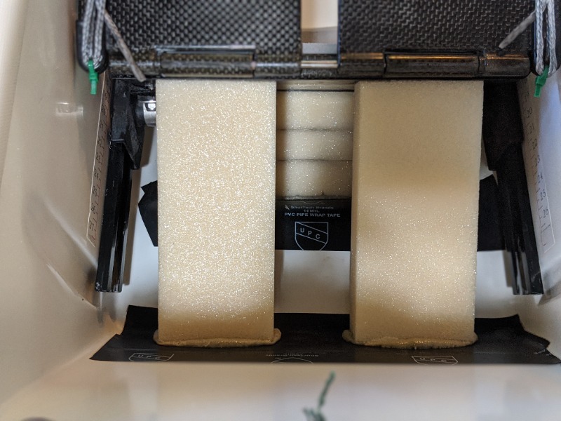

So, to prevent this ever happening again, I decided to go the extra mile and mount it all solid.   I have my distance dialed in and never loan my boats.  A local boat builder gave me some scraps of some very special foam he has.  It's crazy expensive, something like $400 for a 1" thick 4'x8' sheet.   Rigid, waterproof, easy to work and feather light.
I started by using a layer of vinyl pipe wrap tape at all areas on the footplate and boat.  So, If need be, I can pull it all out.
Basically, I pre fitted all the blocks perfectly, (some weird angles in there) with the pins helping me locate the position on the rails.
Used double stick tape to mount the foam blocks to the footplate.  I could slide the footplate fore and aft to dial in the fit.  Then took out the pins (they are not needed) put in a bead of urethane glue and slid the plate up tight to the boat.   Glue acts as a perfect 'shim' and adhesive to mount the foam/plate to the boat.
It is unbelievably secure.  Changed the behavior of my 8 pro and 12.  Zero wiggle, wobble, etc.  With the high blocks, I can press hard with the balls of my feet and the tall foot plate will not pivot.
The footplates do not contact the bottom of the ski, where the rubber thing used to be.  There is an air gap now.  I check it periodically and It hasn't moved a whisker.
The other benefit to this system is that you can tie off those lines so that they will never slip again.   Rudder is always perfectly centered and cannot deviate.
The spectra line will fit thru those standard epic grommets two times.  No alteration needed.  Perfect snug fit.  So, I thread them in the standard way, then back thru and terminate it with a bowline.   Plenty of extra string if I ever need it.  The bowline is zip tied to tidy things up - the snugness of the lines thru the grommets is plenty.  No zip tie necessary.
I'm super happy with the system.  Zero changes to anything stock Epic, and it all comes out.  (with a saw!).
I'm a woodworker, so I tend to overdo some stuff, but hey, it's my boat and I'm tired of fussing with strings and such.
Rock solid footplates add a ton of stability.  And peace of mind.  Very, very strong system.

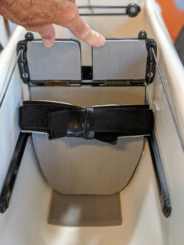

Nice set up. That takes real commitment to leg length but you are really getting some upside with super solid foot plate and fixed length rudder lines. There's a reasonable gap either side of plate - does it allow unrestricted flow of water? Just something to look out for (which I'm sure you thought of) if anyone is brave enough to do similar.
Is the foam on the bucket side of footplate for heel comfort? I get sore posterior heels if paddle over 2 hours but worry that if I padded it, my posture would be affected as prefer heels as low as possible relative to seat.

CrabStick wrote: Is the foam on the bucket side of footplate for heel comfort? I get sore posterior heels if paddle over 2 hours but worry that if I padded it, my posture would be affected as prefer heels as low as possible relative to seat.
Not for comfort - it's a last line of defense to keep that plate away from the boat.  It is comfy though.
It's not very thick.  Brushed finish deckpad stuff from NSI.  Very nice grip on the plate.
