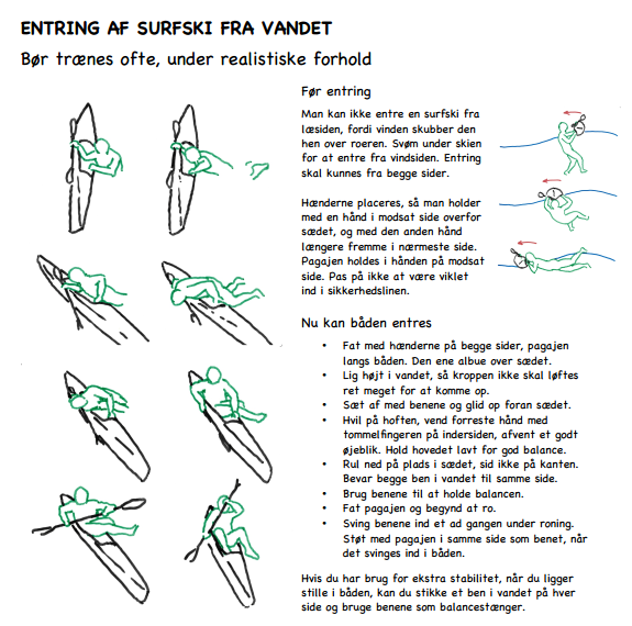

6 years 11 months ago #34809 by Henning DK
As a comment on the side saddle remount, I have found that I have better stability in the sideways position, if my angle to the boat is about 45° (certainly not 90°), and my outer leg is bend to get good contact with side of the ski as well as allowing my butt to slide down into the seat.
Illustration attached, from a small leaflet on surfski I wrote (in Danish)
/ Henning
The following user(s) said Thank You: [email protected]
6 years 11 months ago #34811 by [email protected]
Ha - your diagram shows exactly what I do!  I'm going to OCR your leaflet and re-write it in English.  Brilliant!

6 years 11 months ago #34814 by Henning DK
The complete version of my surfski intro, if you're interested:
www.facebook.com/download/preview/2359669581022874
Let me know, if you can't see it - feel free to reuse illustrations or other parts, if you wish.
The following user(s) said Thank You: [email protected], Hiro, mortenlinding

6 years 11 months ago #34823 by Henning DK
A quick and nice solution would be to simply use my drawings with Robs text, almost same result ;-)

Questions for Henning. Do you suggest facing your torso 45 degrees towards the bow instead of side on when preparing to remount? Which is the outside leg one should keep bent in your diagram, the left one or the right one?
