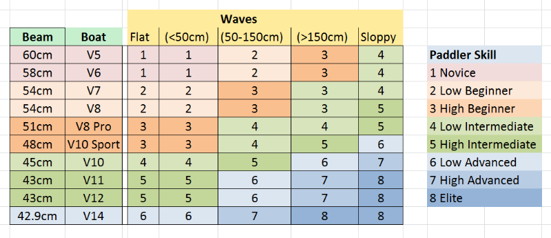

Edit - you got me thinking, really a boats stability looks like the BMI weight scale. Check out the attached image. This is my entirely non-scientific ranking of beam-to-conditions-to-skill ratio. What do you think?

7 years 4 months ago #33780 by mickeyA
Replied by mickeyA on topic Huki S1-R vs Swordfish S?
Wow.  I like that chart.  I’ve never seen it looked at that way. It would nice to get opinions on it, suggestions to alterations, tweaks, etc.  One thing I noticed is the boat itself should not be classified according to its flat water rating, as your colors suggest.  As it reads now, V14 is an overall low advanced ski as it is colored blue. I do not think you intend that to be the case as there would no such thing as an overall elite ski.  I think your “>150” column best categorizes the overall classification of the ski. V14 is elite; v11 /12 high advanced; v10 low advanced, sport high intermediate, etc.  Has anyone mentioned what conditions should we use to classify skis, where balance is not an issue and you are able to put full power into strokes?  I have no issues on flat water in v12, even v14, but I am by no means an elite paddler. More like low advanced or high intermediate based on your chart. Makes sense.  I am trying to decide between v10 and v10Sport for stability in confused, washing machine,  chop, which makes me a 5 or 6 skill level.  Great idea.
7 years 4 months ago - 7 years 4 months ago #33782 by Atlas
Replied by Atlas on topic Huki S1-R vs Swordfish S?
That is a great chart MCImes. It's a good starting point for the extraordinarily complicated process of classifying skis.
One of the appealing things about ocean ski paddling is that there are no hard and fast rules. Stability is a function of so many different factors and every paddler will have a slightly different perspective depending on (among other things) what they are hoping the ski will do for them.
Overall beam is suggestive in relation to the stability of a boat but the underwater shape also has a huge influence. For example the Think Zen and the Nelo 520 have identical beams and they are both on the short side of average. However they are vastly different skis and in my opinion they are in completely different categories. This is because the Zen's hull is very flat through the mid section whereas the Nelo is quite rounded. As a result of their hull shapes; the Zen has very high primary stability and very low secondary stability. The 520 has surprisingly low primary stability but substantial and predictable secondary stability. Not good or bad; just different.
