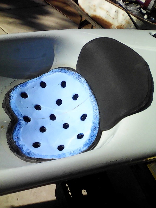

7 years 4 months ago #33605 by Fath2o
Replied by Fath2o on topic Customization Advice Needed
For my seat pads I use closed cell neoprene foam material like you see for a backpacking sleep pad. I glue layers together to get the thickness I want with a more permanent high performance spray contact adhesive. I glue the pads to my ski with the lowest performance less permanent adhesive. The high performance glue is almost impossible to remove later. The pads can be peeled off the ski intact with the low performance glue. And as far as affecting rotation or comfort, my pads are replicated after the ones I have seen elite paddlers like Dawid Mocke using at the
U.S. Surfski Championships.

7 years 4 months ago #33610 by Fath2o
Here's a picture of my seat padding. BTW I am also having great results with my sciatica physical therapy. Apparently my lower back isn't the issue. Guessing it is piriformis syndrome.
