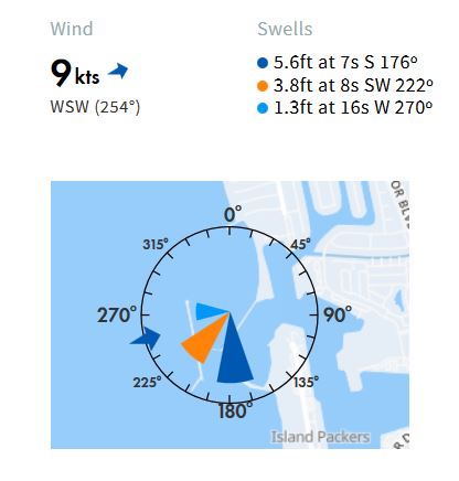

i was out tonight and it was a handfull to stay upright in tri-directional
swell plus a couple knots of rip currents, but i managed. It was about as messy
as it gets around here. If i had a bluefin, it was that sort of night. check
out the wave diagram pic for the conditions.
Anyways, we get steep wind waves from .5 to 1.5m semi consistently, so would
get similar conditions with some regularity. Summer can get kinda flat and
windless at times, but it comes and goes.
