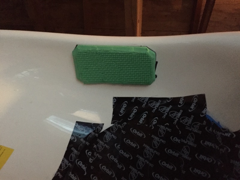

7 years 9 months ago #32376 by zachhandler
Hip pads make a huge difference in stability and control. I use 1/2” thick closed cell foam. A piece the size of a smart phone or smaller is adequate. Here is a pic of the pad in my v12. The black stuff is pvc tape I use over the bottom seat pad to make it more slippery.
For hip pads i t only takes a small piece, up high, and just forward of the deepest part of the bucket.
7 years 9 months ago #32377 by sski
PVC tape for slippery bum so rotate better with good technique?
7 years 9 months ago #32381 by zachhandler
Yes, basically makes it as slippery as the bare gelcoat.
The following user(s) said Thank You: sski
