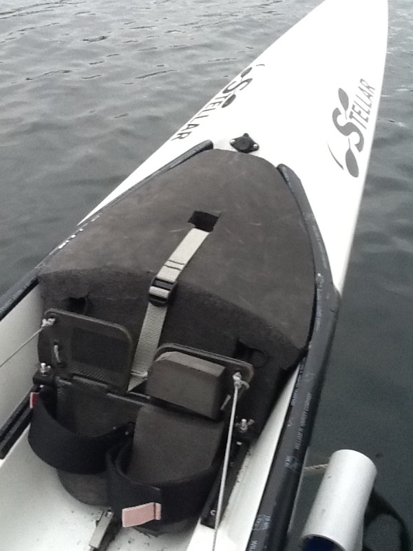

Let see... ok then do what I did to my SR g1. First and foremost get a DK rudder. Like an 8” 15° normal or wide cord rudder. This will make the ski handle much better and you will have much more aggressive controle of the ski. Foam the back and sides of the bucket to move you as far forward as you can get comfortabley and still have stability as you go up in hight. This will help the ski catch runners easer and carry speed a little better. Add foam to the cockpit to take up the excess volum. Fill the whole area in front of the foot board and down the sides back to the seat. In the photo I have the area in the front filled but not the sides built up yet. It make a huge difference to bailing time. Remember the SR is still faster than both the the Bluefin and XT on flat water and will be a better ski than it was with the mods.. especially the rudder Do thoes things and save more money to buy somthig better.
Oh.. cheapest foam I have found is to buy the cheapest foam yoga blocks on eBay from China. Contact cement together and cut to chape.
