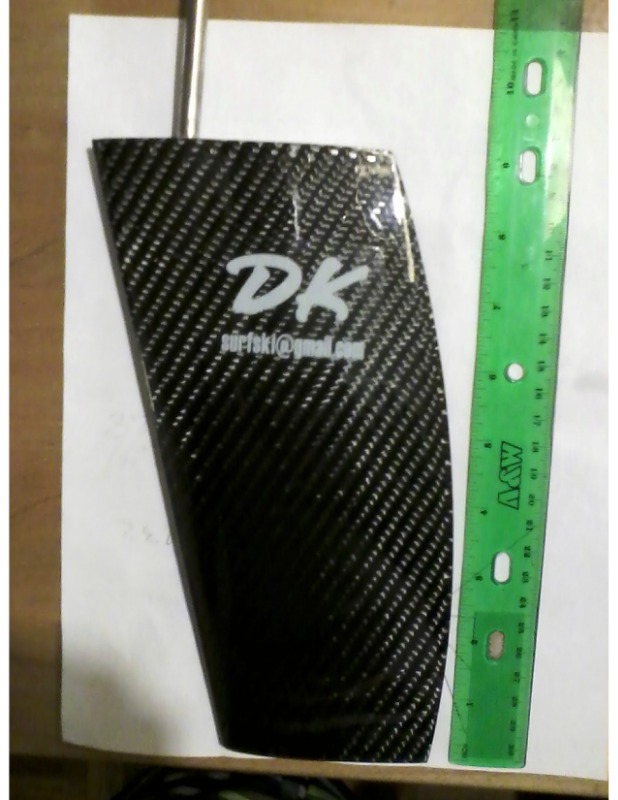

7 years 5 months ago - 7 years 5 months ago #33239 by PSwitzer
Hulk, I emailed Don and asked for something that
1.  Was deep enough to maintain contact while nose down on the crest, and
2.  Stall resistant- able to keep laminar flow at high angles of attack.  I was willing to accept some increase in drag whilst going straight if it meant it would be less likely to stall out while in the business...
And a few days later I had this in my grubby paws..
9 inch deep, 15 degree sweep back, and a full/ convex trailing edge that reminds me of a full battened mainsail on a racing yacht.
And sweet Jesus it kicks ass!  With the crappy 7 incher I was barely able to hold enough angle to keep the bow free, much less take a high lateral line right on the crest.  Now it's like a video game, or having one of those dreams where you are lucid dreaming so you can do whatever you want, like flying...
-Patrick Switzer, Oahu

Nice rudder PSwitzer! The DKs seem to be very popular with all who try them. I don't think you needed a retraction re your earlier post about the merits of keeping your bow out of the wave though. Some excellent points well made.
The rudder can make a difference, of course. The best example for me was going from a standard 8" to a surf 9" rudder on my Stellar SR for a small increase in stability and a big improvement in steering effectiveness. I only noticed the extra drag on the flat.
