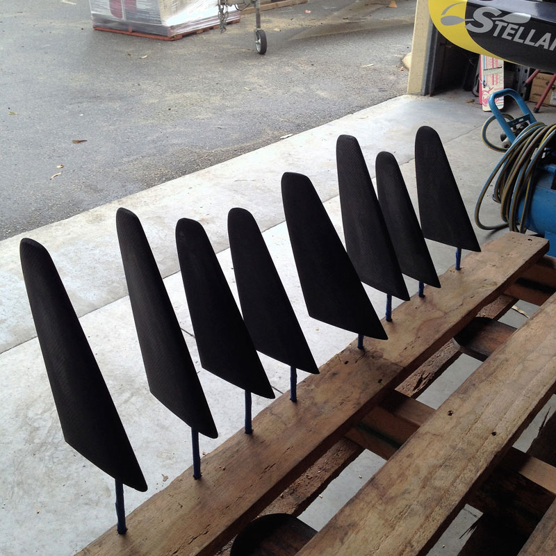

The SES is the only ski in the Stellar range I haven't paddled (I'm too big). But common to all the Stellar Skis I've owned(14) is the steering...What I do from delivery of a new ski - I remove the steering line and replace with 2.5mm Grey Dyneema (solid - no cover). I think the factory use a nylon covered spectra - it has a little give. The second thing I do is put little cleats behind the foot pedals. Thirdly the rudders have been in the past fairly ordinary - I've re-shaped and resprayed (clear coat) all mine. For ocean downwinding I usually use a 9" rudder for 20knots + but in lighter conditions change out to a 8"...All my skis are fitted with my home made weed deflectors too.
Also, the early built skis had the rudder shaft right at the front of the foil - I could never get that to work right either - guess I'm just a hack!

Secondly, buy a new rudder from Stellar. The old rudders are simply the worst rudders ever made. They wander when you paddle, are useless on waves and have a tendency to snap off at the base. However, they make the best weed guards. I have inherited half a dozen over the years and have made about about 20 weed guards. So don't throw it away.

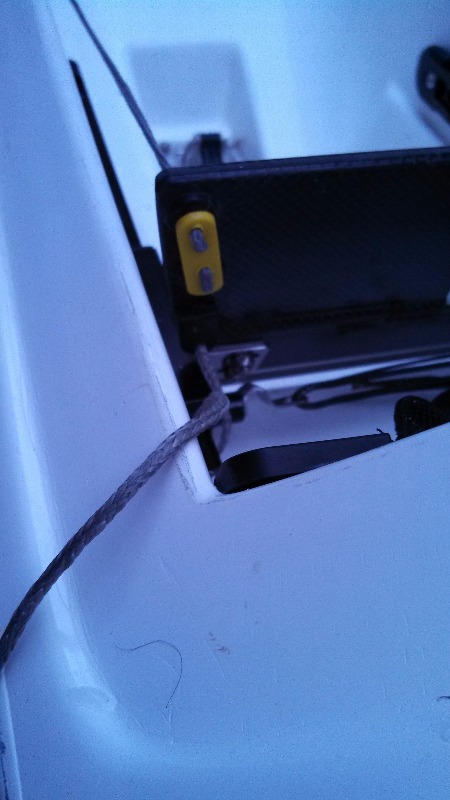

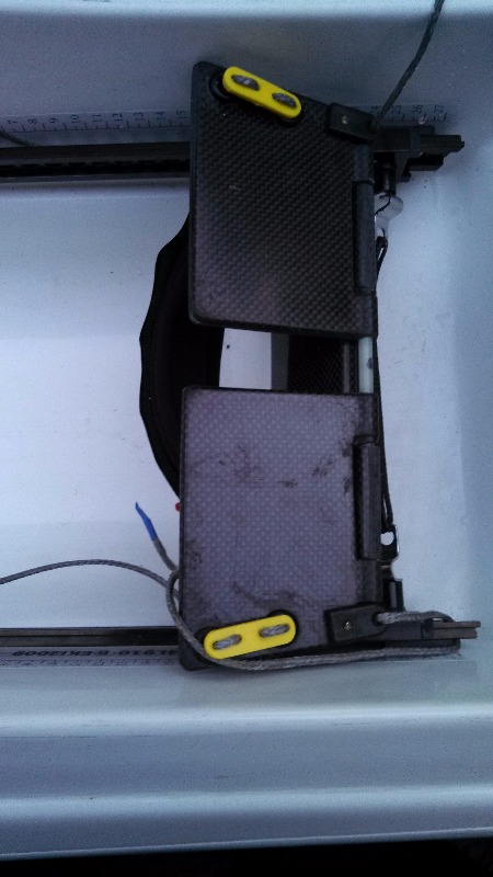

9 years 6 months ago - 9 years 6 months ago #27809 by ccchappell
Completely agree with Dicko.
My biggest problem on the very early Stellars was the slippage at the footplate. Here are a couple of pictures of some small 'buttons' I made to just add enough resistance so no slippage, but still able to adjust. Made them out of left over yellow fiberglass squeegee, but sure you could use any available plastic. Believe these pics are from my previous V12, but same idea. This helped tremendously on both the red tube as well as black tube Stellars I owned
Chris
BracaSport USA Importer
FastPaddler.com
Last edit: 9 years 6 months ago by ccchappell.

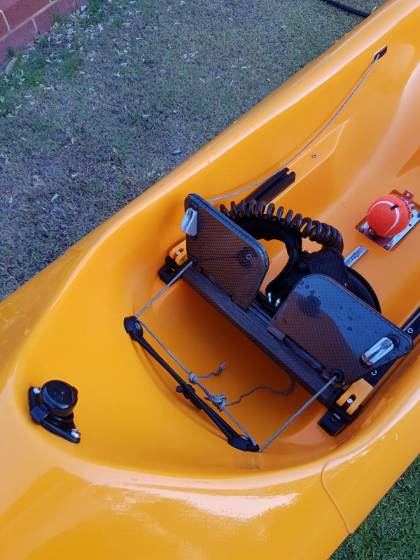

9 years 6 months ago #27812 by Canadasurfskiguy
Thanks for the responses guys.
A buddy had some left over Think rudder cable which is what I used to replace the stock stuff. There's definitely no stretch in it. I had assumed it would instantly fix the problem.... no such luck.
I will try tieing the line at the pedals asap. Though I suspect it will not solve the problem because in my attempts to isolate the issue I've grabbed the line between the pedals and where it enters the hull and pulled towards the bow which results in spungy flexing.
Even though the line is tied between to fixed points (rudder & footplate) it is not taking a straight path because of the zig-zagging housing. When pressure is applied to the line it attempts to straighten itself but that force is opposed by the housing that is trying to stay zig-zaggy.
I really like the hull of this boat (which is why I bought it). I've just got to get the steering and the bailing issues improved.

9 years 6 months ago #27858 by Canadasurfskiguy
FYI, I tied of the cable at the foot pedals and the stretching is still there.... bummer. I suspect the spungy steering is just the way it goes with this boat. If I decide to keep it then I think I'll take the aforementioned advice and buy a rudder with the post in the middle and that should reduce the leverage from which water can apply force to the rudder.
