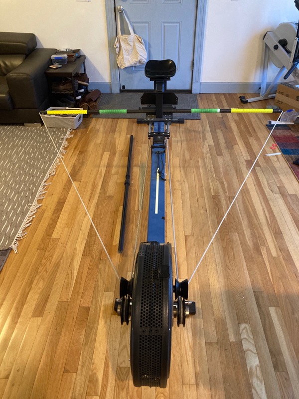

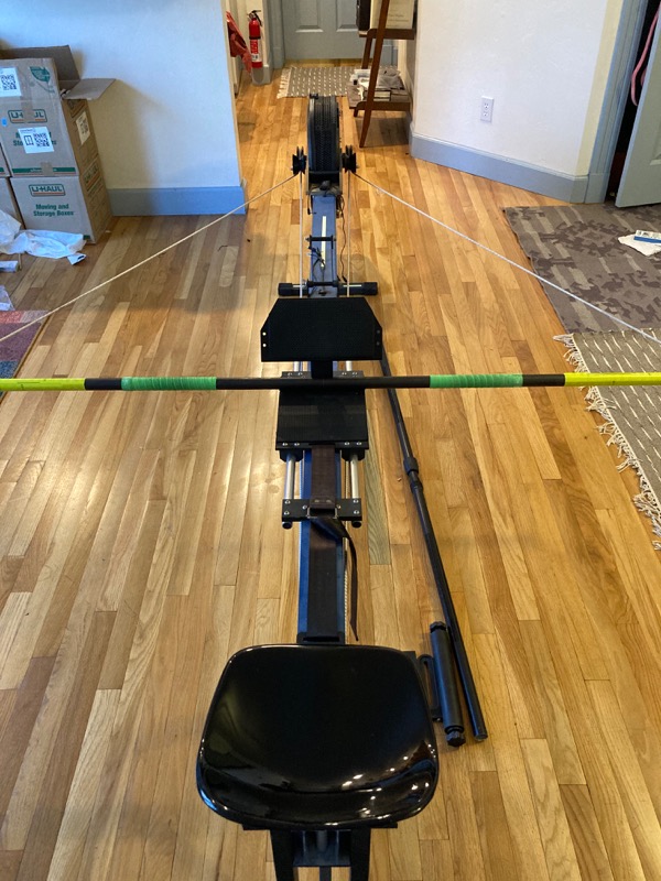

5 years 6 months ago - 5 years 6 months ago #37931 by jsapan
Hi -- I have an old but working Speedstroke Gym kayaking erg.  The only problem is that it does not have a performance monitor.  I tried the KayakPro bluetooth solution ("GenesisPort") and I could get the machine to measure distance, but it would miss strokes, making the cadence data wonky. See below for full details.  My goal is to get enough to get me at least halfway to an another erg, like the Paddlesport Training adapter with the Concept2 SkiErg.
$1200 OBO.  Located in AZ.  Can figure out shipping if there's serious interest.
Original adjustable aluminum shaft included.  Needs one replacement adjuster ($25 from KayakPro + shipping) OR buy a Length Lock 1 adjuster from Epic for $9.90.
Shown with a custom-made carbon fiber paddle rod.  I took the pull bar off the footrest, but it screws back on.

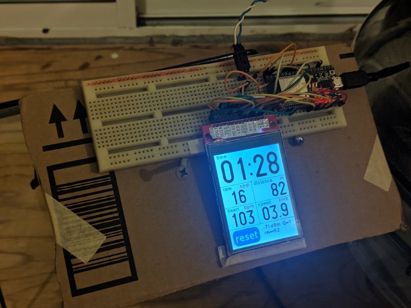

In the off-chance you're interested in building your own performance monitor, I just built one for a water rower. Doesn't do force calculations yet, but that could be added if one is interested in working through the physics and calibration. The current input is the hall switch that detects water wheel rotations. Sounds like a hall switch to count 1/6th turns of the flywheel would work the same. The whole thing is based on an esp32 microcontroller with a very common 2.8" TFT display and programmed in micropython. (It also sends the data to my little home server over wifi so I can plot workouts, etc.) If you're into this sort of thing I can help you get started, if you've never worked with embedded microcontrollers, it's probably too high a barrier for just a performance monitor.

5 years 6 months ago - 5 years 6 months ago #37944 by tve
Quick follow-up, the prototype system I have looks like this (the screen looks a lot better in real life):

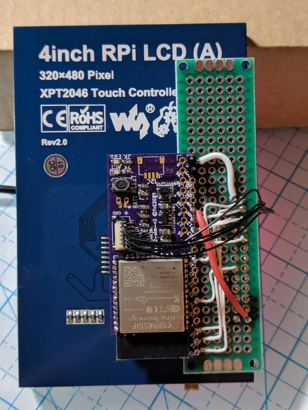

The "real" system's electronics are almost complete:
A few more mods and that's all for the hardware (<$40 in parts).

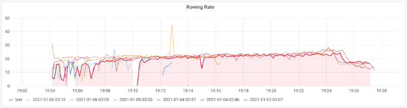

Software is shaping up nicely. The core dealing with the rower pulses is one page. Most of the work goes into the screen driver and the whole font rendering and layout... I can make the code available in a few days, right now I'm reorganizing some stuff... The off-line processing allows me to chart stuff like:
