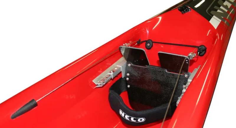

The footrest on my ski looks like this:
So the footrest ends well before reaching the floor. It's very ball of foot / midsole oriented drive and I really like it that way. I think it is replicating a K1 very well. I can only reach the pedals with my toes. It's never the ball of the foot that presses on the pedals.

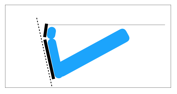

Another issue is my footrest distance setup. My paddling technique is based on the idea, that on each stroke the back of the knee must be pressed against the floor/hump of the ski as much as possible. That was taught to me by a young K1 guy, who heard it from some famous K1 coach while in the national team camp. I like this technique very much and think it adds quite a bit of stability and connection with the ski.
Mine looks like that though instead of the bungie tied to the end of the wire loop it passes through a hole in the pedal with a knot on the front face. This holds the pedal plate upright against the cable clamps so it doesn't fall forward.
Do you have issues with the steel cable cutting through the pedal face?

(edit) I am looking at the picture you posted and wondering if your steering cables are set up and installed properly? Looks like to me the cables should have stops on them so the cable can not slide through the pedal. I believe if the pedals were secured to the cable that they would be self centering. Am I missing something here? I'm pretty sure that is what the bunji is for? Otherwise there doesn't appear to be any reason for the bungi. I'm not familiar with Nelo's though.

Fath2o said: "I am looking at the picture you posted and wondering if your steering cables are set up and installed properly?"
This was a photo taken off some old Nelo website. I didn't have a good descriptive photo at hand and the season has ended for me in August.. But the steering lines on my boat are made of nylon, not metal. They start to stretch out after 2+ hour hard paddles. So for me this was another reason for not setting the pedals parallel with the footrest.

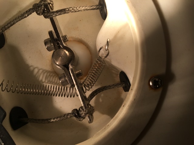

Hey All ,, I love my Epic V7 solution for a self centering rudder so thought I'd share .... Very clean and simple ... Parts needed = (1) Ideally Stainless spring and (2) self tapping screws to mount the ends of the spring into the rudder compartment hull area ... Go to Lowes/Home depot and get an assortment pact of small springs ( about $5) .  ..... Inside the rudder compartment just stretch a spring of the proper length ( pick any coil near the center of the spring  to start ) UNDER the flat silver brace that the pedal coords attach to ....The steering brace is now embedded in the springs coil near the center of the spring ... Then stretch the spring ends to reach the hull material on each side and use the 2 screws to mount the spring ends to the hull material .  ... You are done! ... THEN,, to get the rudder straight at all times ( When  there is no pressure on a pedal )  .. simply scoot the the brace into spring coil that leaves the rudder straight .... Done .. SO SO EASY ! ....    This email address is being protected from spambots. You need JavaScript enabled to view it. if I can help ... Peace

6 years 7 months ago - 6 years 7 months ago #35770 by TRitt
A pic....

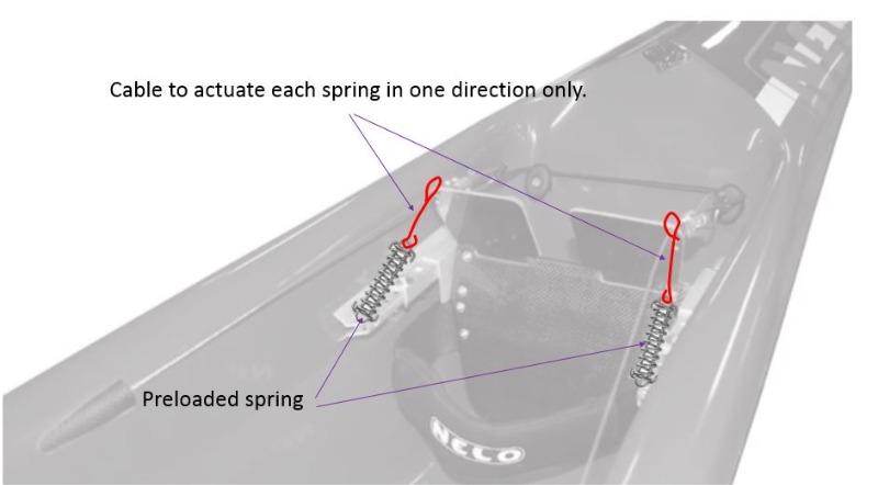

To do it right, you need two preloaded springs. Something like this stainless steel spring:  www.mcmaster.com/9630k58
Connect the preloaded springs to the rudder with a length of cable. That way, each spring only actuate in one direction. Meaning when you turn left, only the right spring is pulled. When you turn right, only the left spring is pulled.
The reason for preloaded spring is so that as soon as the rudder deviates from the center a little, the spring is already preloaded under force to center the rudder.
If you just connect the rudder to the center of a compression spring, there is zero force at the center to center the rudder until it moves enough for the spring to generate force. Your rudder will always be in a dead band a little off center.
5 years 6 months ago #37883 by TRitt
Just thought I'd bump this ,,, See my previous pic ,,, Still works like a champ, rudder maintains center, and just 'blip, the pedal for a quick change in direction ... If a cable were to break  you're left  with a 'straight ' rudder so you can get home safe  ,, no adjustments or maintenance so far, going into year #4 ....
5 years 6 months ago #37884 by waverider
TRitt wrote: Just thought I'd bump this ,,, See my previous pic ,,, Still works like a champ, rudder maintains center, and just 'blip, the pedal for a quick change in direction ... If a cable were to break  you're left  with a 'straight ' rudder so you can get home safe  ,, no adjustments or maintenance so far, going into year #4 ....
I like the idea that it is addressed at the rudder end rather than at pedal end, so that, as you say, if a cable breaks you at least have a skegged  boat without having to get off and rig up a rescue rig at the back, if you even have one that is.

RT, I didn't understand the picture at first but I do now. I can't paddle until the 4th with the new covid measures kicking in today so I'll see if I can sort something like this but with the spring mounted on the rudder cover instead of the actual hull.
5 years 6 months ago #37940 by Fath2o
Brilliant idea TRitt! Could have used this once. Got caught out solo in rough windy cold  conditions with a loose tiller nut. (in case anyone doesn't already know, surfskis are unmanageable with a loose rudder). I repeatedly hopped off my  ski to try and correct with frigid fingers, had very short term success. Finally tightened nut finger tight, centered rudder with foot pedals and headed to shore. Any movement of foot pedals and tiller would disengage rudder post and slip. Had to find person with phone to call for transport. Became very hypothermic while waiting for help at sunset. If a cable breaks, etc., plastic toilet wedges are one good option to center a loose rudder. Another is a bungee at the tail end of ski that can be to attached to broken cable side of tiller to allow one foot pedal steering. Either way you have to get in water to apply. Brrrr!
Oh yeah, your spring method centers the rudder too.
